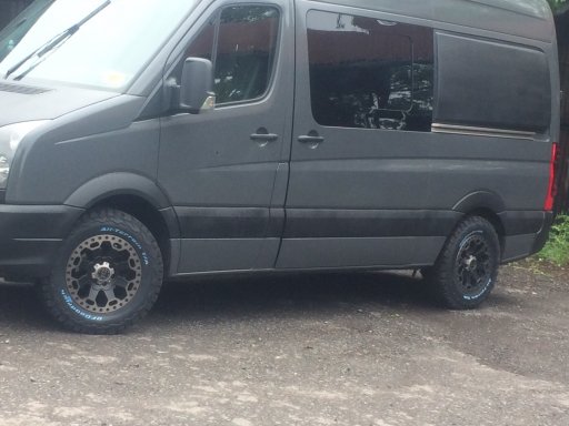

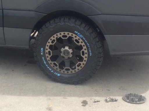

Black Rhino’s with KO 2’s
How do you like the KO2's. What's the diff between Ko2 and ko3 ? They look to fit your wheel well nicely. Do you have wheel spacers ? What size tire are they 315 /?/? .. The 315's I have are 315 R 60 x16. If I had bought the 70 series they may have fir better than they do and I wouldn't have the clearance problem I have. Do you have a name for that Beast ? I hope it's not Suzie Q .. LOL
I love these tires, they’re 285/ 70/ R17’s. Next year I’m moving up to 315/70/17’s. Right now I think BFGoodrich is only making a mud terrain in the KM3 and I named it Destro, loved G.I. Joe as a kid
285's and 315's are the same height, Right ? I want 285's for my Disco and they measure almost 33". The 315's I have for the Dodge are 33" also. but they are 60 series. Tire sizes confuse me. Are you looking for a wider tire or a taller tire or both ?
