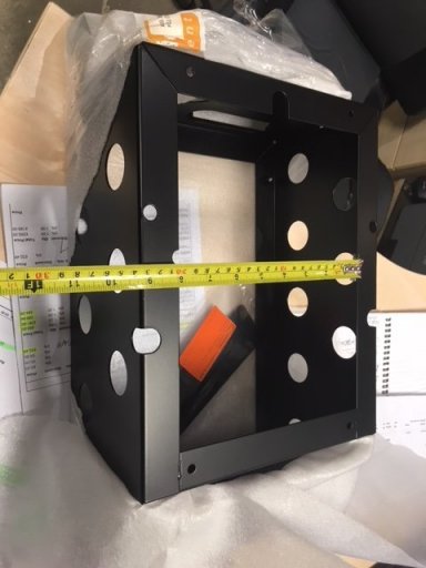

My last purchase was an ARB Twin Air Compressor and Accessories.
I originally planned to fit the compressor either under the bonnet or under the drivers seat. Unfortunately neither locations allow enough room for me to do so. I have come up with an idea of fitting inside a housing underneath my cubby box.
171309-1.jpg )
The housing I am hoping to use underneath the cubby box looks like this. it should be en-route to me from the supplier as I type this.....

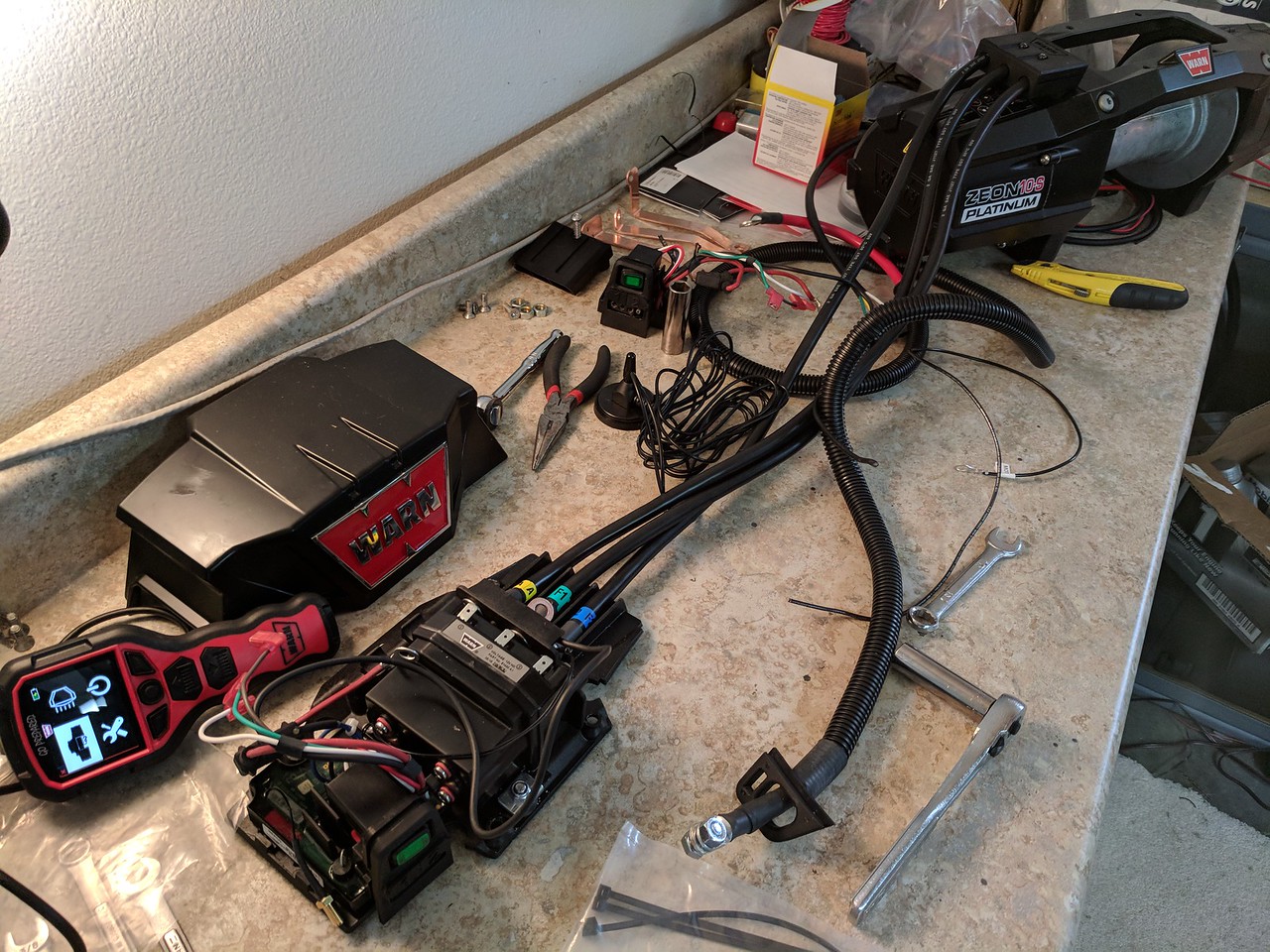

Epic. How is that Warn Zeon control pack relocation kit? I've got a Zeon from another vehicle that I can repurpose but I'd need to relocate the pack.. was thinking of just selling it for one that's already separate.

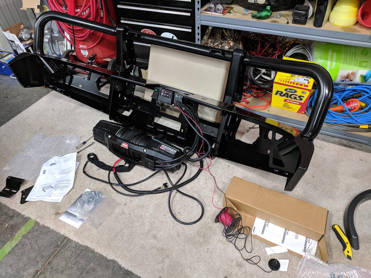

I ordered all this stuff over a month ago, but I finally have it all. Let the massive install begin!
ARB Summit bar, WARN Zeon Platinum 10-s, ARB fog light kit, ARB Intesity 9.5" (THEY ARE MASSIVE). lots of other install kits... wohoooo
None of it is hard to deal with. The short relocation kit I used is 31". Its basically just the three main cables from the control pack to the winch. I also did the enhanced signal kit to get an antenna on my roof for the wireless remote on my Platinum.
You basically have to rebuild the whole inside of the control pack, which is silly, but not a problem. I am disappointed in how they implemented the high beam aux link 'feature' .. im going to have to install separate relays to activate them with high beams. The warn zeon platinum can't turn aux on from high beams, it can only require that the high beams be on to manually turn on the lights.. STUPID feature.
Anyway... I am LOVING the bumper and the winch is super nice. I need to get out and mess with it more. Soon I might be using it to pull cars out of snow banks and ditches, which will be fun. Always used a tow strap in the past.

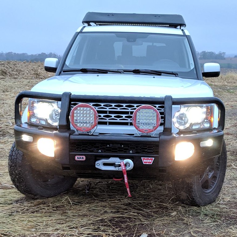

I think I posted this in another thread, but I realized I didn't show the final result of the post from above...
I did install the flip up license plate holder which covers the winch fairlead.. after this corn field poser shot.

Beautiful Rover. Thanks for the details, that's funky with the high beams. Relay's are easy though so at least it's a simple fix.
It is a simple fix, but its extra wiring that could be totally avoided if they had actually 'linked' the aux to the little high beam wire they have. wasted opportunity. I hope they fix it and I can replace it.
I will have to use two fused relays, two switches (so i can choose which of the two lights come on if at all with the high beams), and some Y splitter cables (one path for the winch aux and one for the high beam relays), etc. I hate extra wire. I have a very simple, clean, water tight, setup... and anytime you add crap, you add complexity (i know, modern rover guy complaining about complexity... but I mean non-factory complexity. ) Lots of rig problems can be attributed to aftermarket changes, and I don't want that if possible. Its more stuff to clean also when you get things dirty. I like that the ARB bumper has solid metal under shields, to protect all the stuff up front, including the air suspension distribution block/valve block. I need to work more on the inner wheel well plastic, to make it solid and not move or let in dirt/rocks/water... I want that thing solid so tree limbs and debris can't get into the engine area or front bumper area at all!
