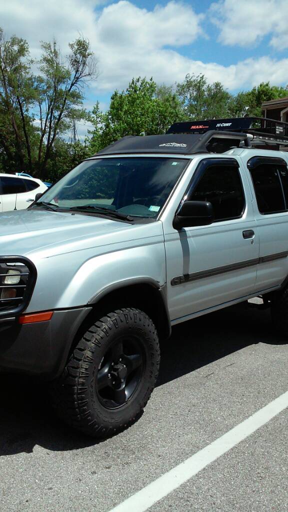

I finally installed the Ballistic Fab rear diff. cover that I purchased a couple months ago from a TNX member. I liked the raw look of it so instead of painting I used Duplicolor Adhesion Promoter and clear coat.
While I under there I also [finally] installed a rear diff. breather extension.
I also changed the front diff. fluid. Mobil 1 75w90 Synthetic now in both.

Makin' some progress...
Winch, LED fog lights and bumper...installed
Grille...repainted but not yet installed
HID conversion kit and projector retrofit...done
Oil change...done
No-Spill Systems oil drain valve...over-torqued and broken (that's what I get for not following the directions provided by No-Spill and torquing to Nissan specs...oops)

Tonight I wired the winch up and installed the Factor 55 ProLink. Also installed a license plate re-locator bracket on the Hefty and did the easy fog light bypass posted on TNX.
I still need to install a grille (just bought an '05-'08 grille) and tweak the Hefty bumper mounting a bit.
