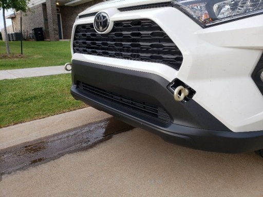

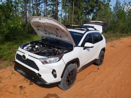

In any case, I've been making some good progress on the Rav!
Got my tow hooks built: when connected together through a rope and pulley, they should handle anything I need. My engine bay gear is a little better situate, with the hi-lift base and body, lift-mate, and winching chains all stored under the hood to distribute the weight around the vehicle. My hi-lift beam and handle are now mounted on the roof. And, a full ReadyLift 2" lift is on the way! I'll probably post a full write-up once I get the lift on and get a chance to actually use the vehicle on a trail or two.

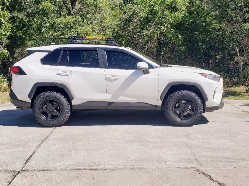

So, I ordered a full-sized, non-matching spare tire and cheap steel wheel this morning. I walk out to leave and have a flat...
Once I finally got that taken care of, I ordered a new set of Goodyear Duratracs and matching 5th wheel so I could run a matching full-sized spare. I am now going from a fatter 30.1"(255/70R16) tire to a narrower 30.4" tire (215/85R16), because a 215 is the widest that will fit under the cargo area.
I wasn't expecting to spend another $800 today--though I'll get maybe 400-500 back once I sell the current barely-used tires and the factory donut. But, I am excited about going a little taller on the tires, having a more aggressive tread, and having a complete matching wheelset. I'll post up pics next weekend when I get the tires and lift on!

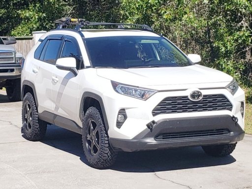

Tell me about those Duratracs on the highway? How are they running 70 mph on the Interstate?
They're loud as shit....
This new gen Rav is already not a quiet vehicle, but these tires are almost as loud as the Treadwright Guard Dogs I had on my Samurai. My wife's Milestar Patagonia MTs on her 4Runner are notably quieter.
Honestly I think the only benefit to these tires is they are probably a bit longer-wearing than most other very aggressive off-road tires, and have reportedly good winter traction relative to ATs. But, if you are looking for a street / weekend warrior tire that wont see huge rocks or mud bogs, I probably would not recommend these simply due to the noise.
I had already been considering a sound-deadening project, but this is really pushing me in that direction. So, that said, once that is complete, I might really like thse tires, heh.
