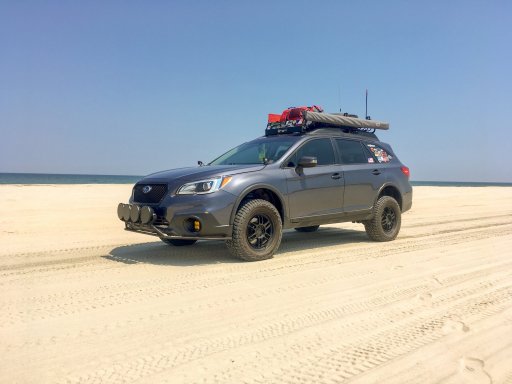

Here’s a little mpg rundown @Baipin. Back when the car was like this on G015’s the best daily driven mixed mileage mpg was 25-25.5
Take the basket off and the mileage was essentially the same but only because of the cold weather. I’m sure I don’t have to tell some people in here but newer Subaru’s are absolute pigs in the cold. So sadly I can’t tell you an accurate equal conditions mpg.
Fast forward to added wind resistance and heavier Wildpeaks and my mixed average fell to ~24 mpg
For the first time in years I’ve removed the basket and like the last time it’s winter so the numbers are skewed but this is what I can report. Without a Christmas tree on the roof the car runs 500 rpm less at 65-70 mph. I’m not even through a full tank yet but based on what I’ve seen so far my guess would be ~27 mpg in any season other than winter haha.
Reactions: dolli310 and Baipin
Dang, that's some awesome MPG. I've got a 2010 Foz XT and as much as I love the 4EAT transmission off road (it's a beast), combined with the turbo, those measly 4 speeds just crap out gas.
I actually just yesterday took everything off the top of my car (cargo basket, awning, even the factory crossbars), so I can see just how much of a difference those are making to my MPG. I'll report back when the verdict is in.

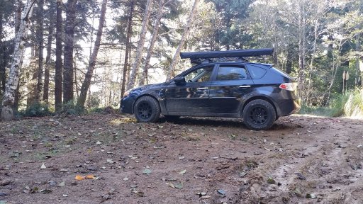

Howdy everyone,
It's taken me a bit to finally read through this post and I've liked a lot of the vehicles I've seen. I'm glad there's a community of like minded individuals who like to have fun with their Subarus. When I set about modifying my Subaru I was met with a lot of confused looks with a general reply of "Don't people usually lower Imprezas?" Yes they do, but I like to be a special little flower. So I give you my lifted 2011 Impreza Outback Sport.
I've been experiementing with my mods so it's a bit of a mess, but here's what I have as of now.
In the front:
  1. King Springs
  2. 3/8" Strut Hat Spacers (made them out of scrap aluminum)
In the Rear:
  1. King Springs
  2. Outback Strut swap (2" longer than Impreza)
  3. 1.25" Subframe Spacers (made from scrap aluminum)
  4. Control Arms with Camber Adjustment (forgot the manufacturer...)
  5. Primitive Rear Diff Armor
  6. 19mm Whiteline Rear Swaybar (I drive mountain roads A LOT)
Other:
  1. Method Racing M502 15" Rims
  2. General Grabber AT2 205/75R15
  3. Curt Roof Rack
  4. No-name light bar (will be removing soon)
  5. No-name Awning (gift, but it's actually not bad)
Overall I have a decent 10" of clearance in the rear and about 9" in the front. I'd like to hack into the bumper at some point but I just can't get myself to cut away at it. I originally had strut hat spacers of ~1.5" all around 1) I would like to do something like Anderson Design's spacers in the front since I don't want to knock out the studs in the new strut mounts I installed, and 2) the rear is maxed out on lift...for now.
Speaking of tires, I started with the Geolandar G015s and they were great on the road and trail, but I found them lacking in the mud. Their ice/snow performance was okay, but I have limited experience in that environment so I wouldn't trust my input and I was only driving through it for a couple miles at best. What turned me off the most was the wear, I had zero tread after ~30k. So I decided to try the General Grabbers since the guys at dirally seem to like them and they were only $300 for the four. So far I like them, the traction is great on trail, but of course not the best on mountain roads. The road noise is...different. Definitely more howling coming from my car, but with all the wind noise from my roof rack I barely hear it!

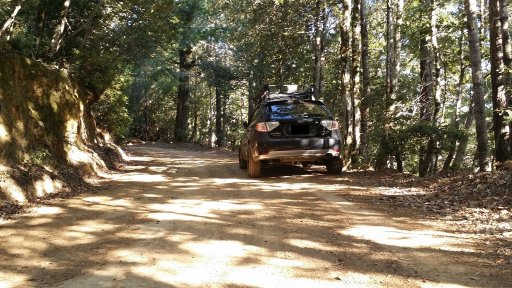

First, here is an obligatory picture of the Appalachia Wander Wagon a guy took on a little softroading trip I went on w/ some MtnRoo folks..
Now here is the question I have been tossing around: if I install a snorkel, will I be stuck w/ the cursed CEL always being on?
This fall I am planning on going on a 4k+ mile odyssey from the Carolinas hitting trails on the way to & around Colorado & Utah & again on the return trip. Our convoy of 4 will include a Wrangler, Tacoma, & Silverado 1500 - so I’m already the plucky underdog. I’m starting to make a to-do list now so I can allocate funds when I get my taxes back & my bonus at work so I’ll be ready to rock. I’m upgrading some of my trail lights & I’m getting them professionally wired using an Infinite Offroad control panel after Christmas but after that here are my next steps:
  • Rock Sliders
  • Storage drawers in the rear
  • Second battery
  • Fridge
  • Trans temperature gauge
  • Maybe a trans cooler? Undecided bc that would definitely throw a lot of the warranty out the window (currently at 15k on the odometer)
  • Quick connect front sway bar links (the RalliTek adjustable ones I have now can be disconnected w/ the center screw thing but then it leaves the pieces that are connected to the car hanging there & I’m afraid they’re gonna jab a hole into something)
  • Horizontal mount propane tank
  • Racks to hold jerry cans on the basket (2 for fuel, 1 for water)
  • A bolt in weapon locker to store my second amendments when I’m in unfriendly states
  • Change my rear setup to the RalliTek 2.25” Rear Super Overload Springs & Strut assemblies (currently have 1.5” spacers, Bilstein struts & stock height king springs back there). I’ve noticed a definite difference in the rear w/ the Wilco Hitchgate & spare back there. The hitch for it also is lower than what I had before.
After I do all of that the only thing I have on my list as a maybe is a snorkel. But I don’t want to do it if the CEL is always going to be on. Anybody have any insight on this?

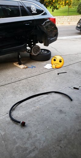

I did the Fuel Canister Bypass mod last night. I followed Bruceys video on youtube and bought most of the things on Amazon and the local hardware shop. The hardest thing was removing all those push pins.. there were so many. It saved me roughly $30.00 dollars compared to buying the kit from LP Adventure. The one thing I couldnt find was a cap for the old hose so I cut a wine cork in half and it fit perfectly :).
