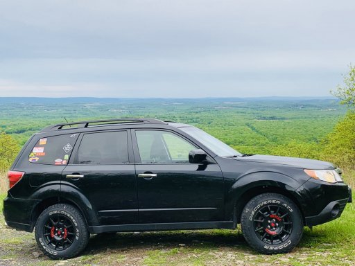

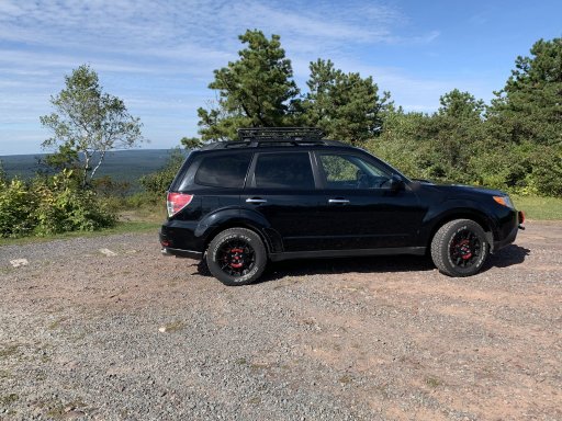

That's impressive. I've got 225/65R17's on my 2010 Foz and it's definitely the largest I can go.
Getting those on there required a small amount of wheel well liner shaving in the front to avoid scrubbing when about halfway between straight and full lock. And the tops of the front tires clear the spring perches on the struts by maybe a centimeter.
And in the rear we actually had to take an angle grinder and ball peen hammer to the front fender seam. When it was in proper balance after the lift, springs, tires, adjustable camber arms, etc the tires were literally touching the fender seam (resting hard against it actually). After grinding some slits in the seam and hammering it up against the wheel well, it's now got plenty of room (and is still structurally sound).
