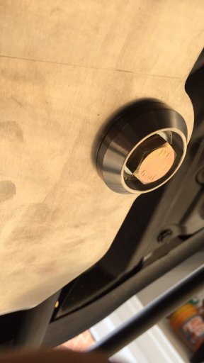

Thank you Thank you, Terry and Wawa!!!! This is exactly what I was hoping to hear. I'm leaning towards a similar install to Terry's. With the ADF installation did you also install the Multi link Spacer? Thoughts on upgrading all springs or just the rear springs to handle extra weight or saggy but issue?

Yes I got the multi-link, it was recommended. I will be going with front and rear springs to balance the car. In the future I want to get a winch installed from LP, the hidden one for my 2017. So additional # up front.

I can only speak for the 5th gen Outback but it is very lightly sprung. Even without any additional weight up front the car benefitted greatly off road with higher spring rate springs as well. All the weight on the nose going downhill used to rob a lot of travel/clearance with the OE springs. Thanks to the weight of the engine a nearly stock ride quality can be expected.
In regards to the multi link spacers... necessary evil. It's a shame but if you're lifting 2" you're going to want them. Sadly that means that the net gain in actual clearance out back will be 0". The SF Foresters were the last Subarus to have a rear sub frame setup that allowed you to only space the trailing arms.
