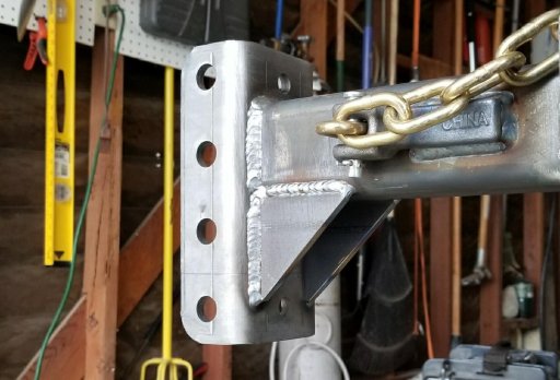

My tongue is adjustable length and uses a removable pintle hitch, when the pintle is removed the pin lock is reinstalled for a little more anti-theft protection, Ron

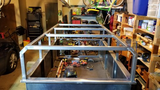

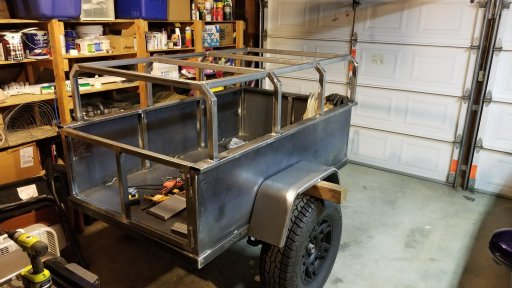

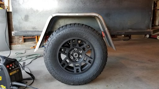

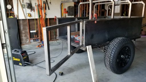

It's been a busy couple of weeks for me with work, sports for the kids, a few trips here and there. Priced out a peice of stainless steel for the drop down table on the back of my tailgate. Started adding the top supports to the rack of the RTT . Ended cutting the fenders to spread the distance for the tires. Pictures to come. May add the adjustable coupler for the pintle in the next couple of days.Resized952018022195163850958477.jpg

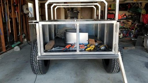

I got my stainless steel table. I need to build a frame for it now. I'm almost to the point of making my decision on whether to powder coat, or have the trailer Line X. Any pros, or cons on either?

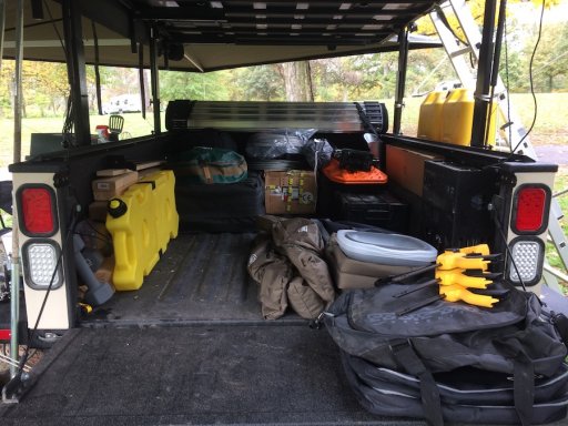

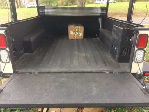

A professionally done Line-X job is wonderful, though on the inside of the trailer, on the tub floor and inside of the tailgate, I sometimes wish my trailer was not Line-x'd, as it can be a bit rough on the bottom of gear sliding in and out. No real problems with it after a bunch of camping over several months, but I suspect over time the bottom of some of my gear, all-weather bags, and Wolf Packs etc will see some wear they may not have had otherwise, possibly even from just abrading while traveling long distances.
It can also be harder to clean and, according to the pro who does the Line-X work for Schutt Industries who made my trailer, takes a good hot steam clean to bring it back to looking new. "I don't mean a home pressure washer" he said, but some big pro steam-cleaning outfit. I'm not too concerned about it looking new, but can understand it being harder to clean.
Everywhere else--on the inside tub walls, upper edges of the tub, everywhere underneath on the frame (I mean everywhere), fenders, complete nose box--I love the Line-X job and am super happy with it. Pics below. The outside walls of the tub are primed with a military primer and ready for topcoat. I'm going to use farm implement paint for that to match whatever color I keep the van.

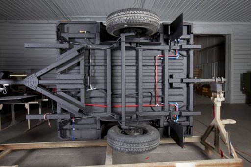

I'll include a pic from Schutt of the underside of the same trailer I have, if that helps you at all. They put them on a spinner when they're working on them. This one shows the mil spec pex-style water and propane lines before the 22 gal water tank and its armor goes on, and the front supports for the nose box. You can also see some of the over 300 huck-bolts. Pretty amazing system, can be dropped out of a helicopter onto the battlefield or into disaster recovery situations.

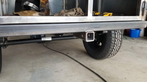

2018031095110428.jpg Rear receiver welded on for the bike rack. Then, had to slightly adjust the rear swing out gate. The top rack supports pulled the sides in just enough that the gate wouldn't close smooth enough.
