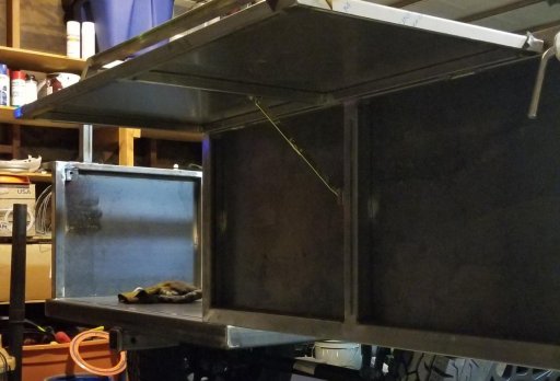

The back swingout gate is now skinned. I have my latches on the inside, which gives the back a clean finish for nothing to snag on.

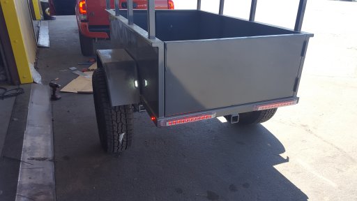

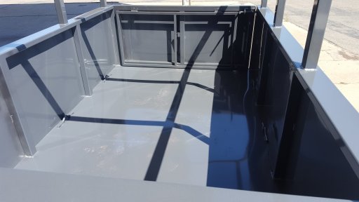

I got my trailer back today. Not bad looking. It does have a few spots that are a little light on the powder coating. Overall, I'm happy with it. Just need to do the wiring, and it'll be ready to go. View attachment 54393 View attachment 54394 View attachment 54395 View attachment 54396
Where'd you buy that from?
Just kidding; you've done an amazing job on this; very nicely designed and extremely well built. I'm really looking forward to how you outfit it now.
