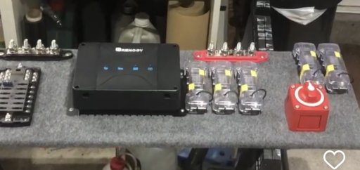

Good day you you all.
I have been using Renogy for over a year now and very happy with it. Probably have done 8k miles with this system on and running my 52L National luna fridge. I have a 200ah battery and room on my board for a 240v inverter if i need it. I do not have solar only alternator. When the batter is to 20% it take 2 hours driving to charge. Running the fridge, LED lights and charging phones etc i use around 8% of battery a day and that is with the freezer on!!
