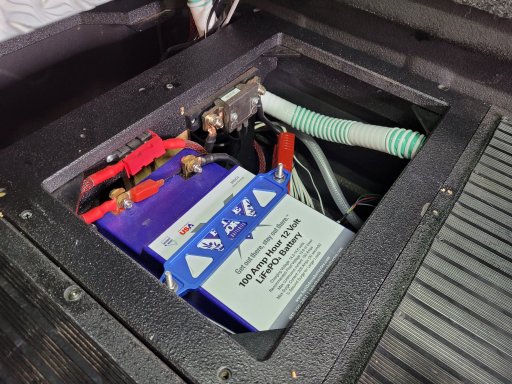

I went ahead and got the EXPION 360 100ah and the battery tray hold down they have...Now its pencil, ruler, and tape measure time...I will post pics when I'm done.
