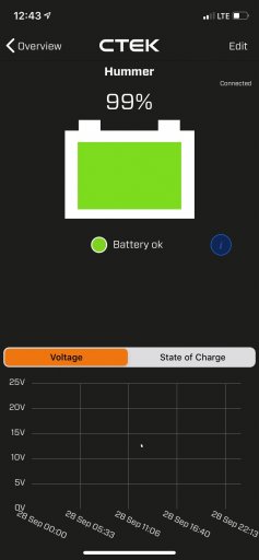

I use the CTEK setup ... here is how I designed the system
These items can be pricey but I found mine cheap in the scratch and dent on amazon
