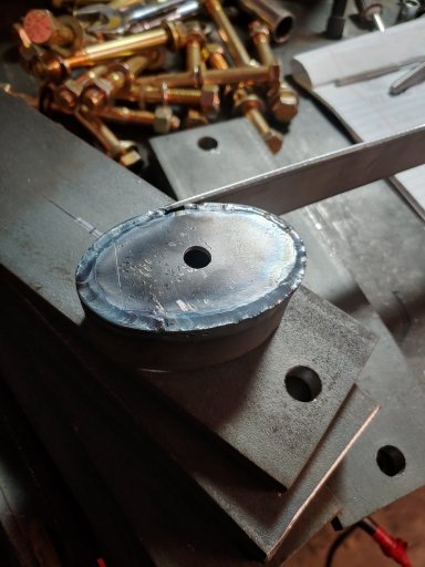

I made some pretty good progress the last few days on the sliders.
I marked out where I wanted the 3 rock lights and drilled the pilot holes.
Then I used a couple hole saws to make the rough hole. Then I used an end grinder to remove the remaining metal.
Then I fabricated the buckets that would weld into the holes and house the lights.
After I made 6 of those it was time to start welding them in the holes.
A little bit of clean up and a coat of primer later,

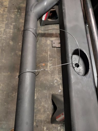

Lastly, I pulled bare wire through the main slide bar. I will use it later to pull the 2 strand wire through that is needed to power the lights.
