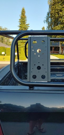

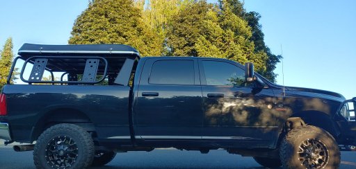

So looking for a solution for mounting plates was not easy. There are not a lot of options out there that fit my build. I ended up going with the leitner universal mounting plates. They were not cheap, but they are nice, shame to have to grind, cut, and weld on um....
Here are the plates layed out for spacing measurements ,
108454

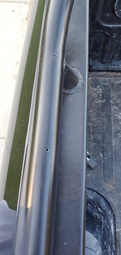

Then I layed out for slots in the rack that the plate tabs would slide in to and drilled some stop holes. I will cut the slot with a grinder and skinny wheel,
108455
Here is what the plate looks like after some trimming. Also had to take the bends out of the mounting tabs,
108456

With the plate mocked up in place, need to make the slots a bit wider. It's a tight fit right now.

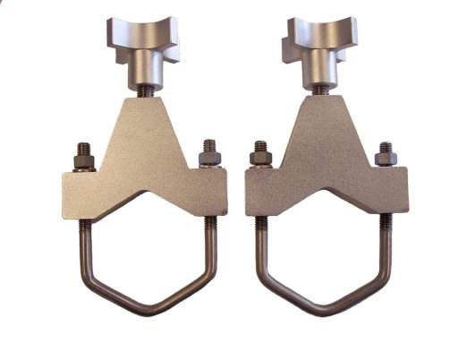

I use the tube mounts from hi-lift. But a bolt and a rubber strap was the way i was thinking. You can drill a hole through the bolt that goes through the hi-lift shaft to put a lock on it. For my boards i used the same deal on the back of my tool box but ground all the thread off the bolts drilled a hole through them and had two locks on the top and cotter pins on the bottom. Used big washers to keep the pins and locks off the boards. Think ifs half inch or 3/4 bolts. With the hi-lift ive seen kinda that same deal. Bolts go through the pin holes hard bolted to a rack. Can slip a washer an nut on it and tighten them down pretty goodIMG_5789.JPG. I had a set of these from hilift its self.

So I was able to get the plates installed before the weekend. This helped make it possible to make a run south to Bend Oregon to pay a visit to CVT.
I got the tent mounted and headed for the forest for my first night in my new digs...
