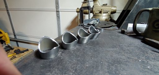

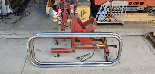

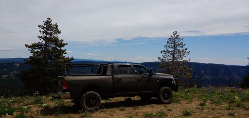

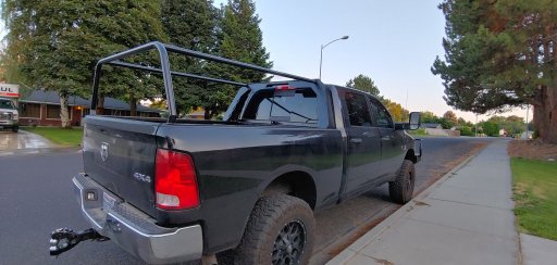

Today I was able to get the window sections bent up and welded. I also finish welded the upper horizontal bars to the rear bar. Also shot some paint on it for the week so it won't rust.
106802
These are the lower supports for the window sections....
106808
And as it sits tonight...
106809

This deal is looking really sharp! Pickup is very sharp!! Can wait to see what else surfaces with it. Window guards will look neat!!

Thanks! I try to take care of her.
"window gaurds" , like the air deflector things....?

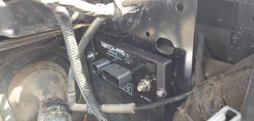

Over the last couple weeks I was also able to finally get my Switch-pro installed.
Found a nice little spot under the hood....
106866

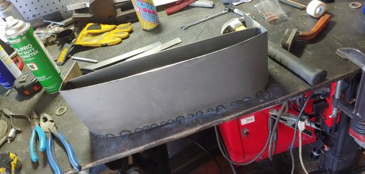

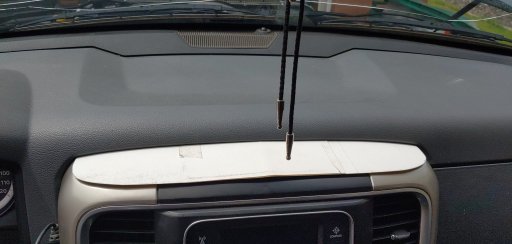

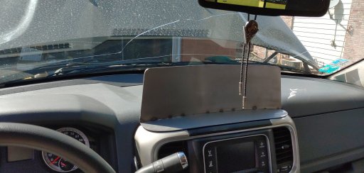

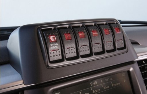

And as many of you know, there is not a real good spot inside for the switch panel. I am also tired of having a bunch of randomly placed suction cup mounts. So I fabbed a panel for my stuff....
106867
106868
106869
And the final product....
106870

I misread the window deals you made. They are going on the side of bed rack? At first glance was thinking they were going up on the head ache rack to protect the back window but looked again and I figured out what you were talking about. The ram 1500 I had was the blacked out 2017 model. Love black on a pickup! The air deflectors on the head ache rack is cool.

Thats cool as well! I had the switch bank from AEV on mine. Fits just like yours. Very ocd about clutter on my dash so it was nice to have it in one spotIMG_5718.JPG

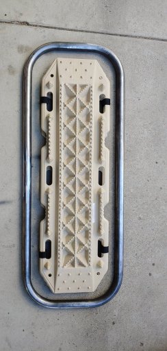

I ordered a set of the Maxsa Traction boards and they arrived today. When I made the rack "windows" I planed to mount the traction boards in the opening. Because I am a little impatient I built them before the boards arrived. I am glad they fit.
