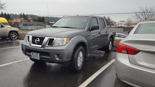

well pigpen is at the body shop getting all fixed up and in the mean time I have a fun rental , I was actually considering getting rid of the subi for one of these ( in a pro4x trim ) so this kinda worked out having one for at least a week . View attachment 81633
I miss my Xterra. I had an 06. It has a pretty rad motor in it that’d was killer for off road. Always considered trading it on a Fronty but ended up selling it [emoji58]

i also have the inclination to get a 3rd gen 4runner . The original idea of getting the Subaru was so I had a new car that I don't have to work on so I can concentrate on my Jeep but now being that I'm selling the Jeep I really could use something more capable cuz even the Subaru being built it's still only going to work as well as probably a stock regular four-wheel drive vehicle.
