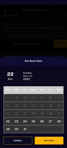

When Creating a rally point in the Android OB1 app I could only set the date (Start/End) to the current month. I tried swiping and clicking everything with no success.
Android 12, Samsung S21 Ultra
Reactions: Michael

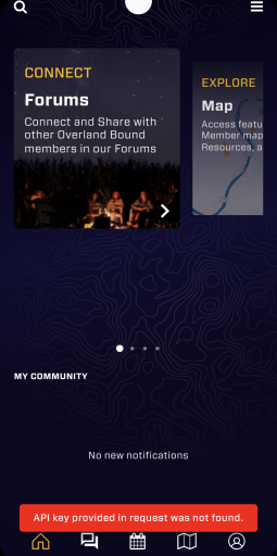

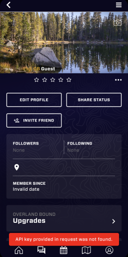

@Michael
Android 12.1
Pixel 6 Pro
App v11.9.2
Repeatedly receive the error 'API key provided in request was not found.' when navigating to the home, forums, or profile screens. Forum content does not load.
Is this still happening with latest build? Delete app - re-install?
JustJP
Seattle, WA, USA
Justin
Pool
42429
Now on v11.10.0 and it was still happening until I cleared all app cache/storage.
Now it seems to behave until I enable biometric authentication and reopen the app. Going back in and disabling biometric authentication doesn't resolve it, I have to clear all app cache/storage again.
Might have something to do with editing certain app settings?
Reactions: Michael
