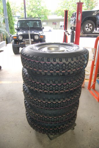

After 40 years of being a tire freak, I went back to my roots and bought some 7.50R16 Yokohamas for my TJR. Saved $200.00, they are rated for 100K kms, all the KOs, MTs, DTs I've had have been bald by 75K kms. So I just cut my tire costs in half.
Plus these are the smoothest riding tires I've ever had on a Wrangler..... I also saved 50#.
I cannot say for sure, but I think my gas mileage is better too.
And they just look soo cool.
