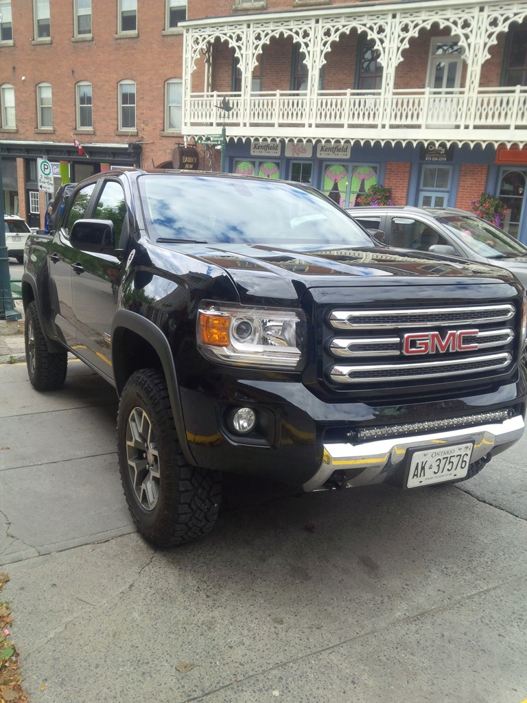

Started as this...
Now looks like this...
I'll fill in the two years worth of modifications in future posts. Its a 2015 GMC Canyon. I have had it for two years now, 73, 000 km's. This is my first post on Overland Bound...seems like a great site and community, stoked to join all of you.

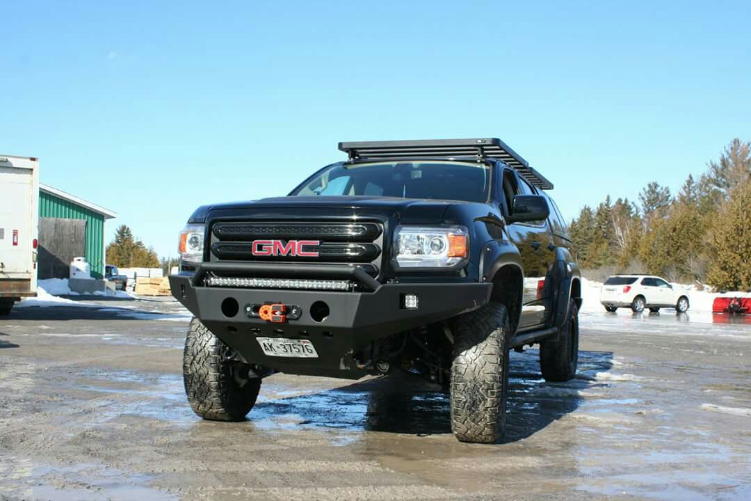

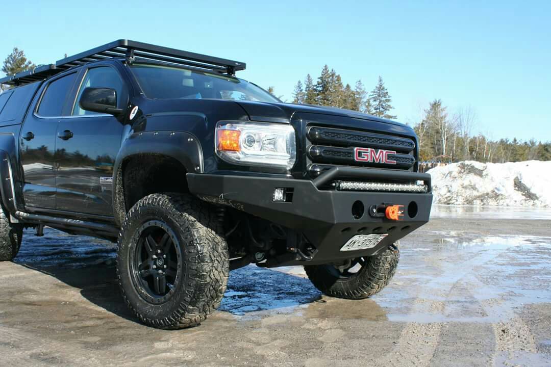

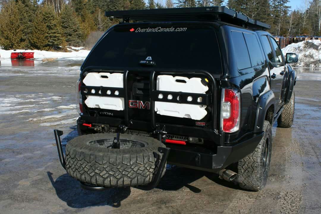

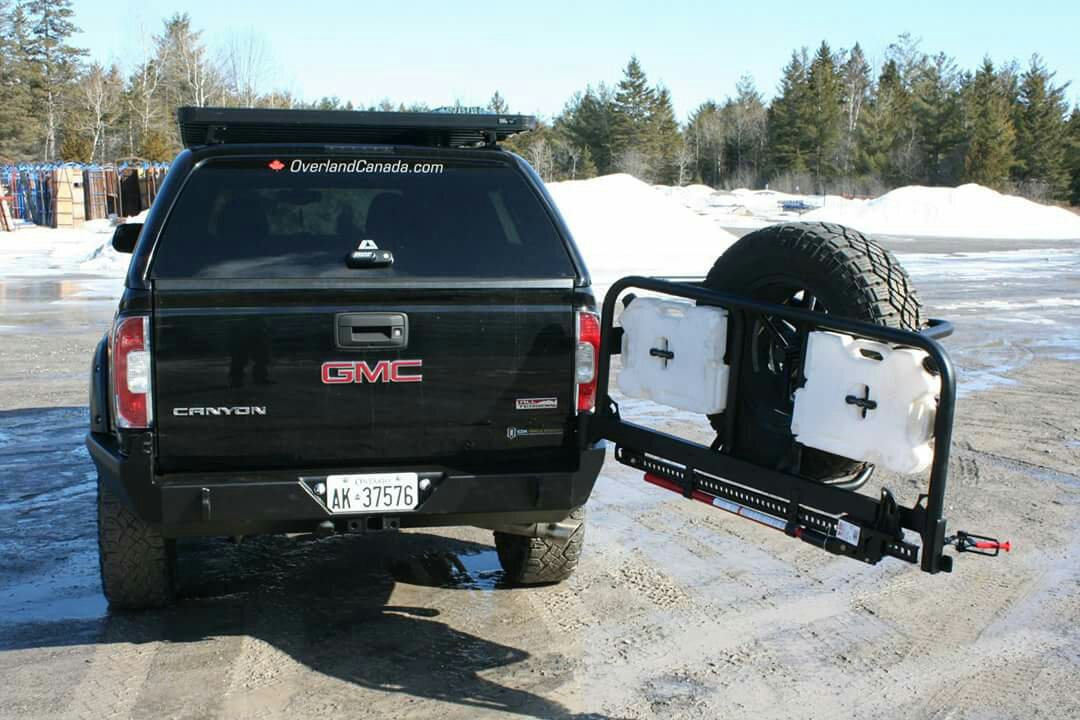

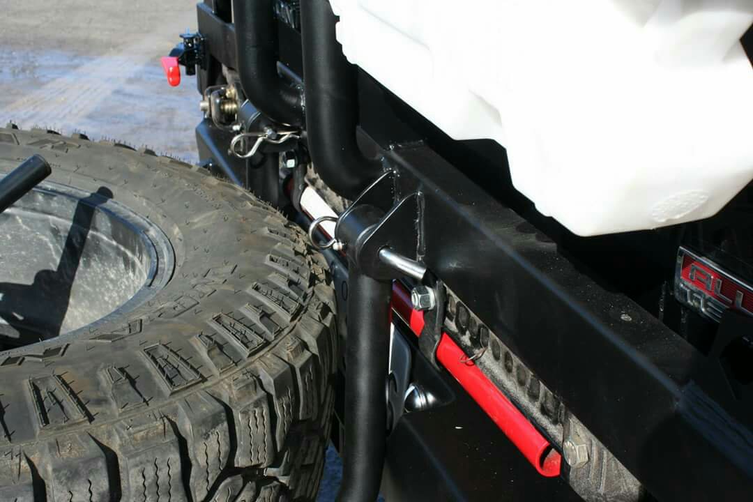

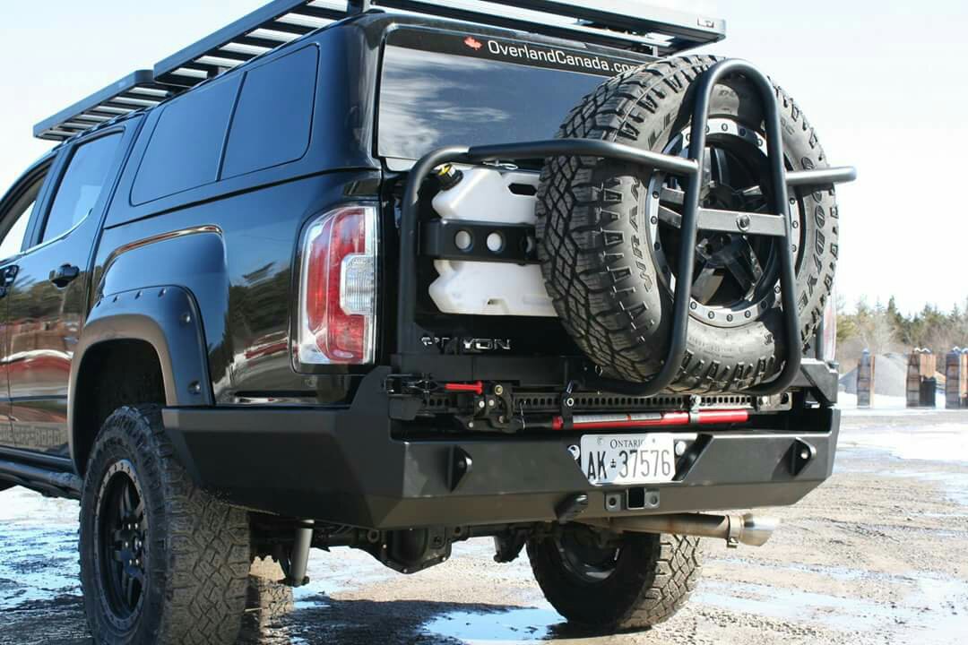

Some high res my fabricator took after completing the rear bumper. Re enforces my desire for a good camera
The truck will likely never be that clean again, lol.

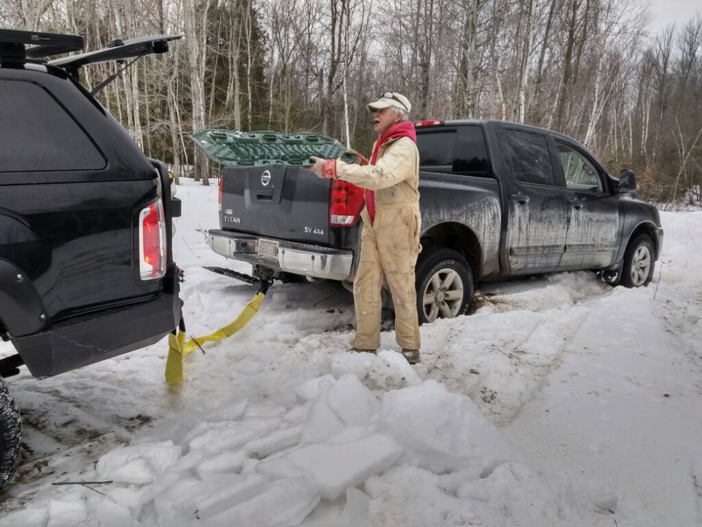

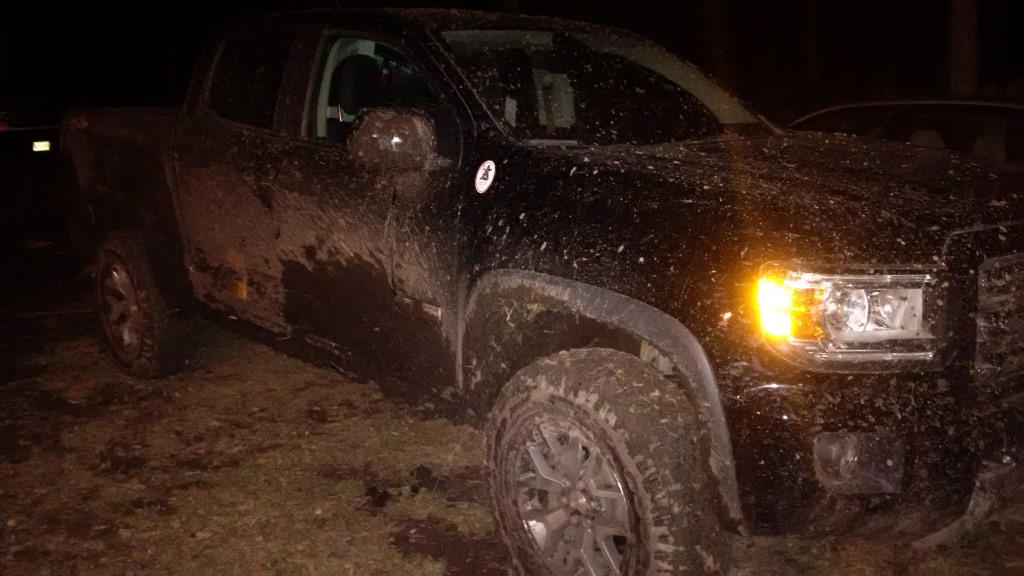

Had a comedy of errors out snow wheeling the other night. Winch, tow straps, recovery boards, pushing and pulling, etc. If it could have went wrong, it did. Can't wait for winter to end

Thanks for the info and photos. Your fabricator did a fantastic job. Hats off to him; love those bumpers.

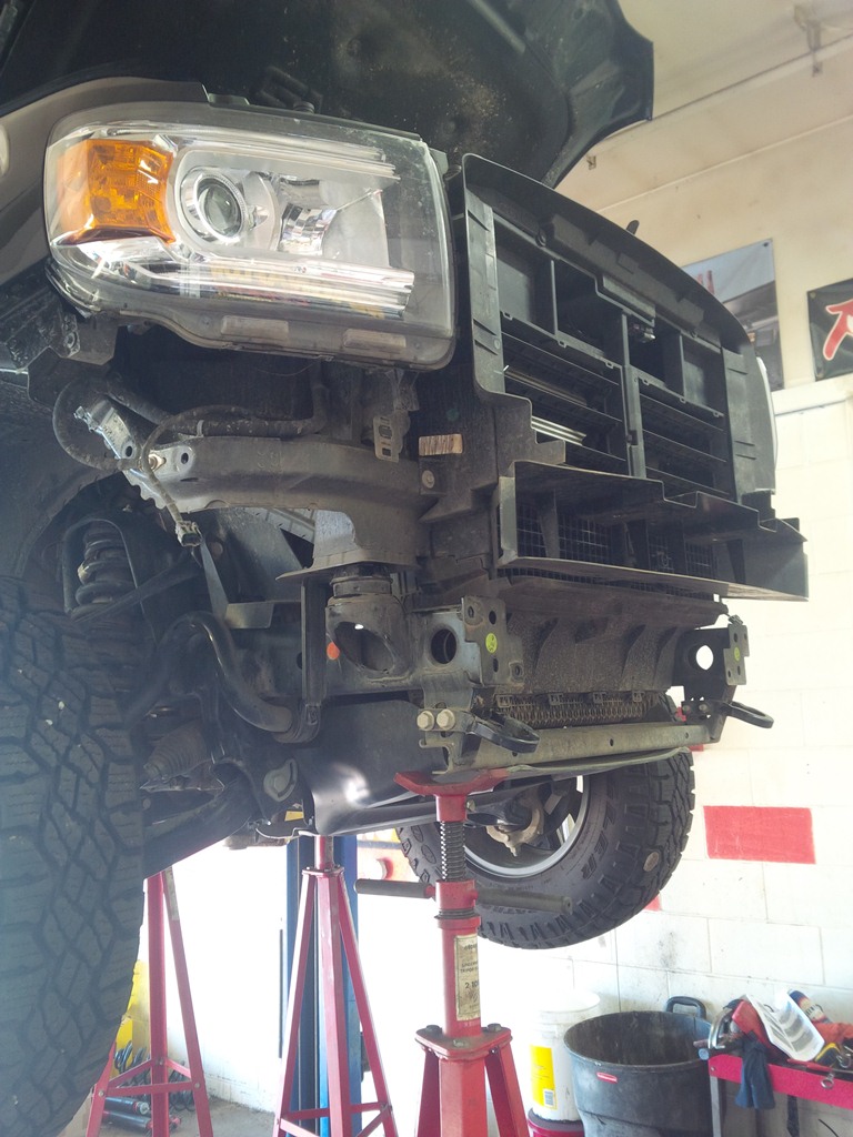

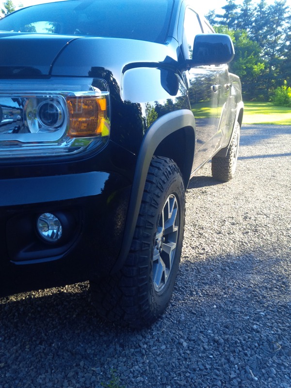

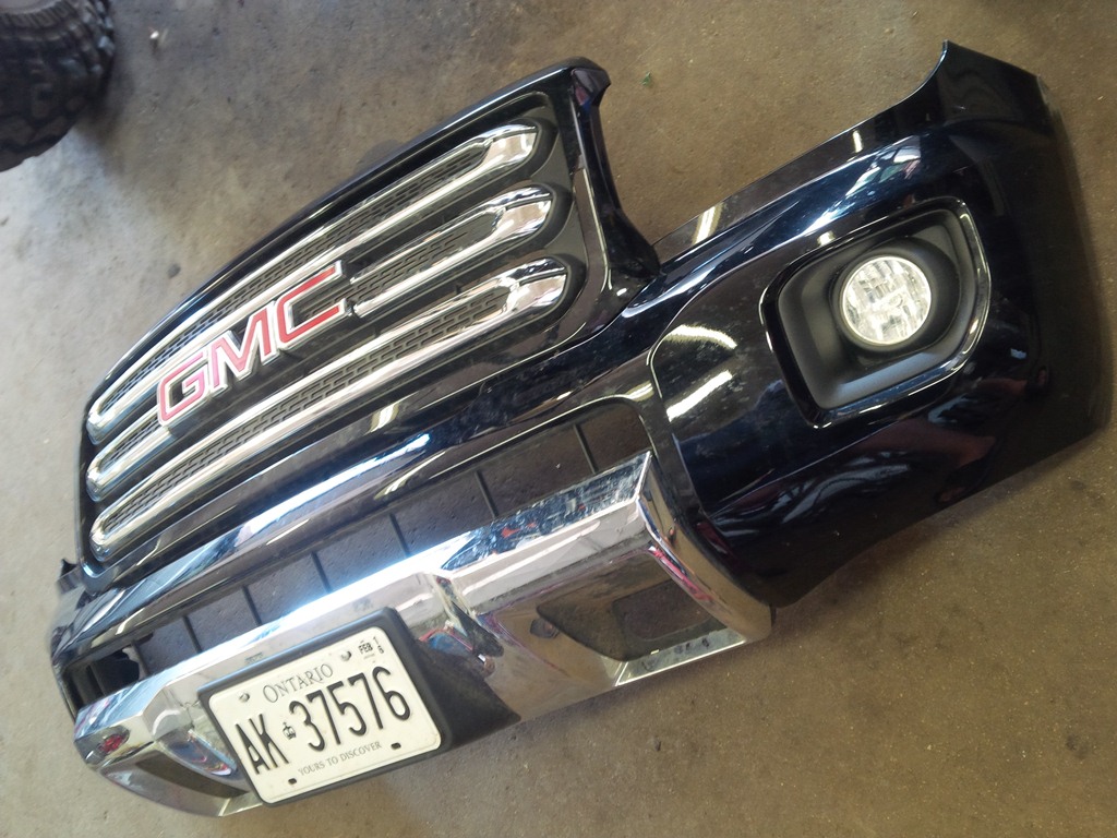

Okay, here comes a two year build compressed into a few posts...

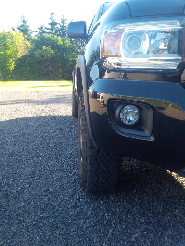

Started with a 2 inch RC level kit and removed the air dam from under the front bumper.
Some easy trails with this setup. For the money spent this was a worthwhile addition to the truck. The RC level kit is two spacers compared to most companies one spacer. Having to remove the springs on the coil overs was a chore but having the shock and spring compressed gives a better ride than just compressing the spring.

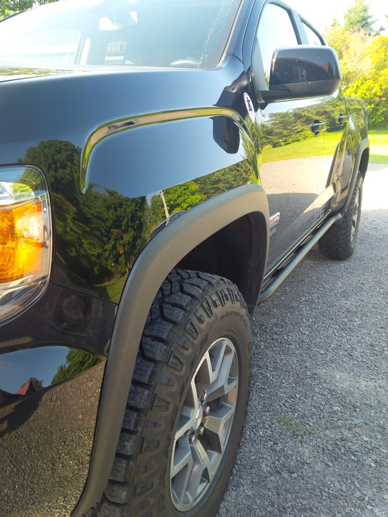

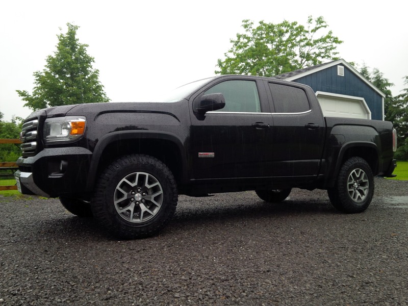

Put some 32x10 inch Duratracs on it

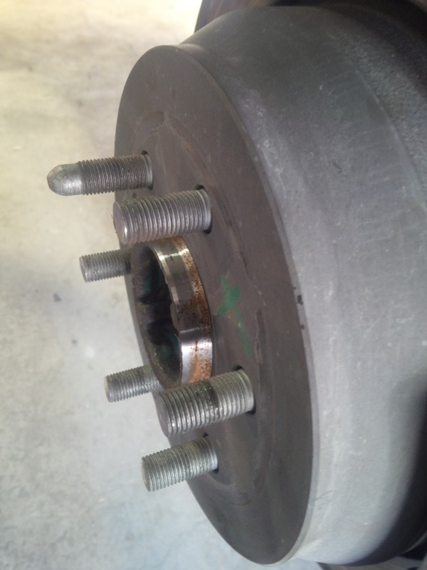

Added some one inch hibcentric spacers. Had to grind off the nub on the bolts.
Gave the truck a nice stance

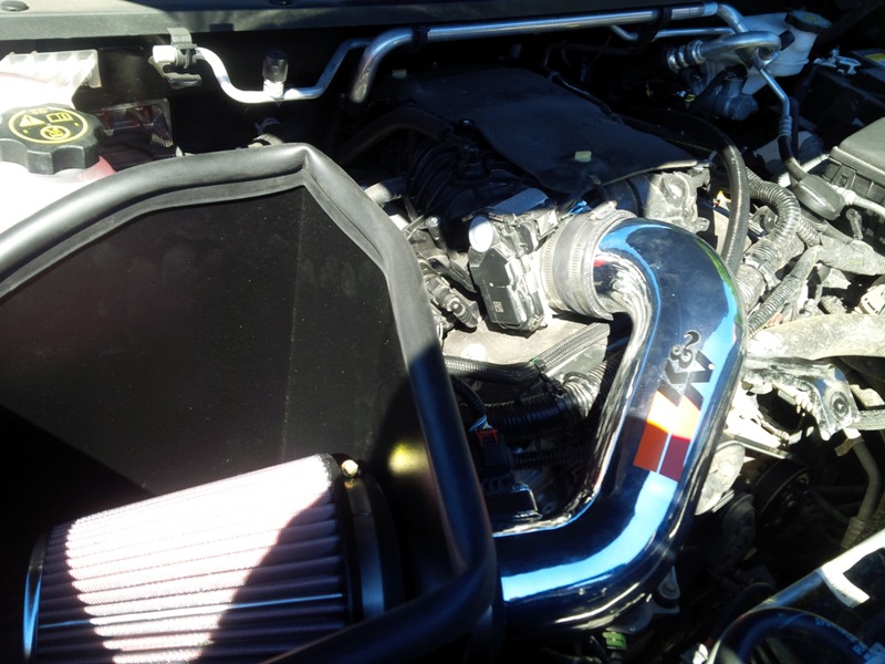

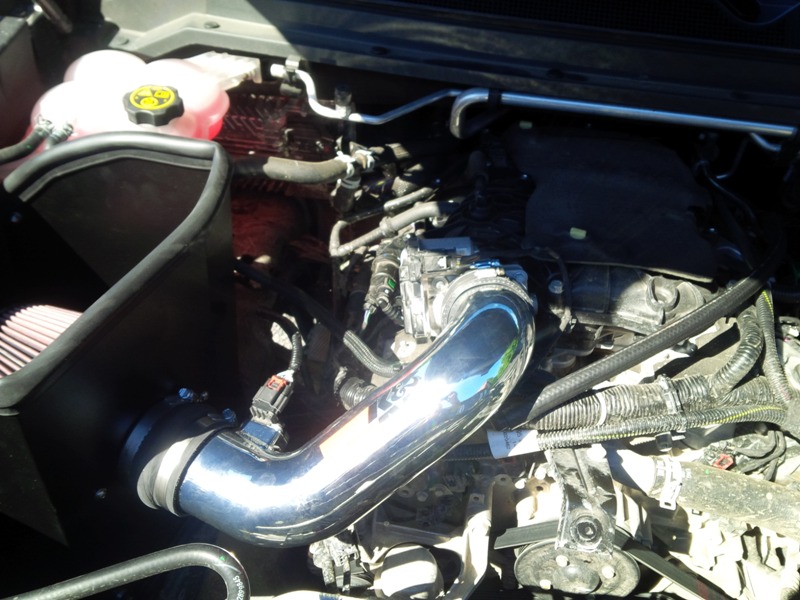

Installed a k and n cai. Ran it for two days then took it off and sold it. WAY too loud

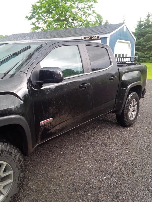

Enjoyed the truck for a while with this setup.

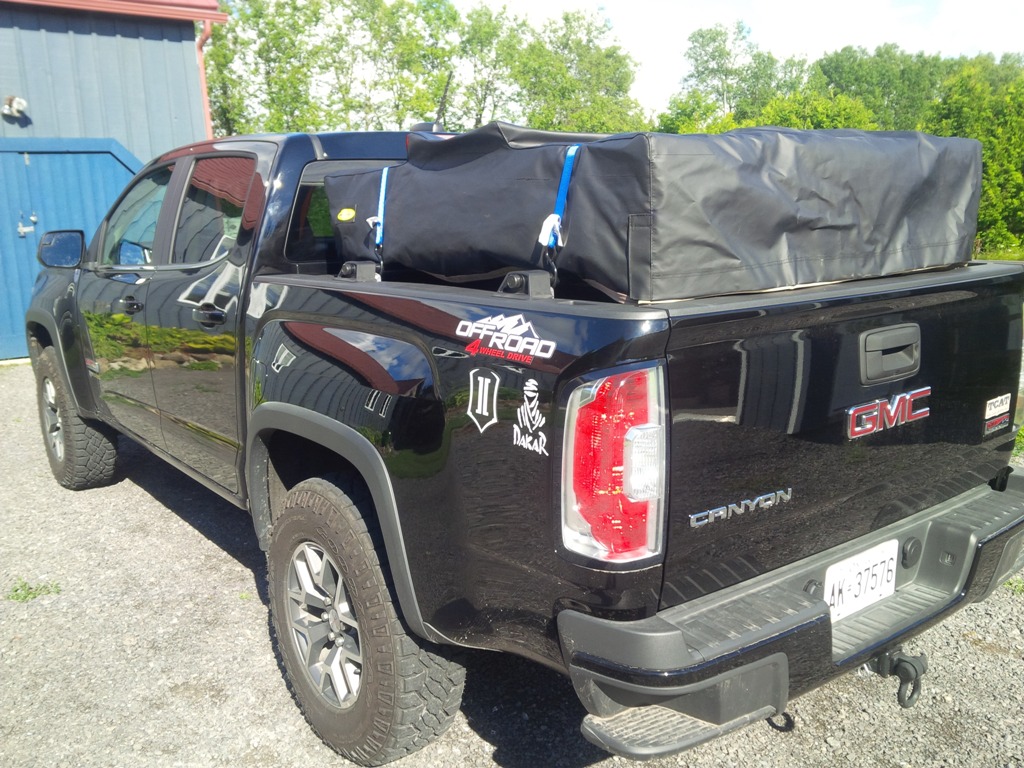

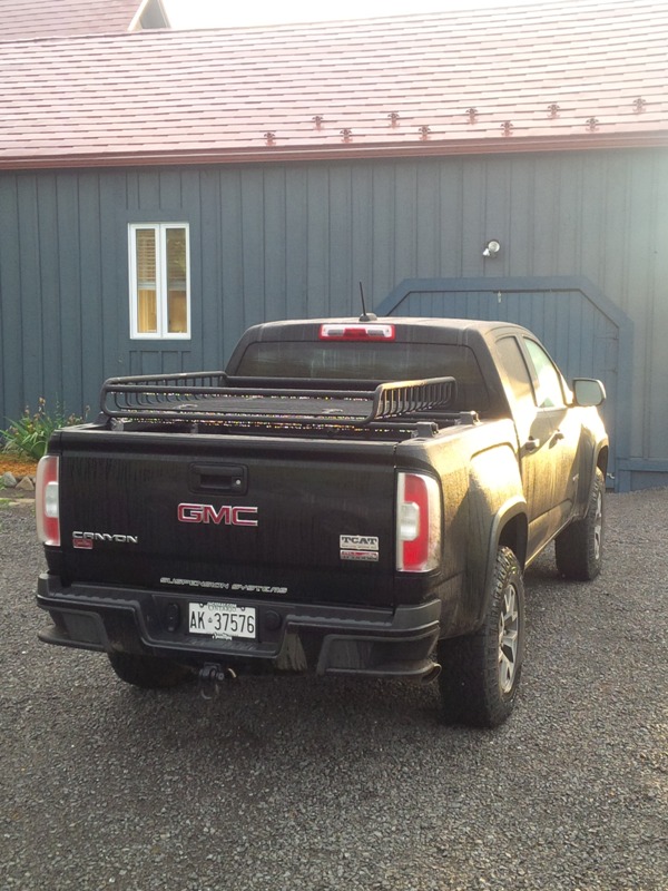

Installed a Yakima bedrock system with a tray. Worked well, no complaints.

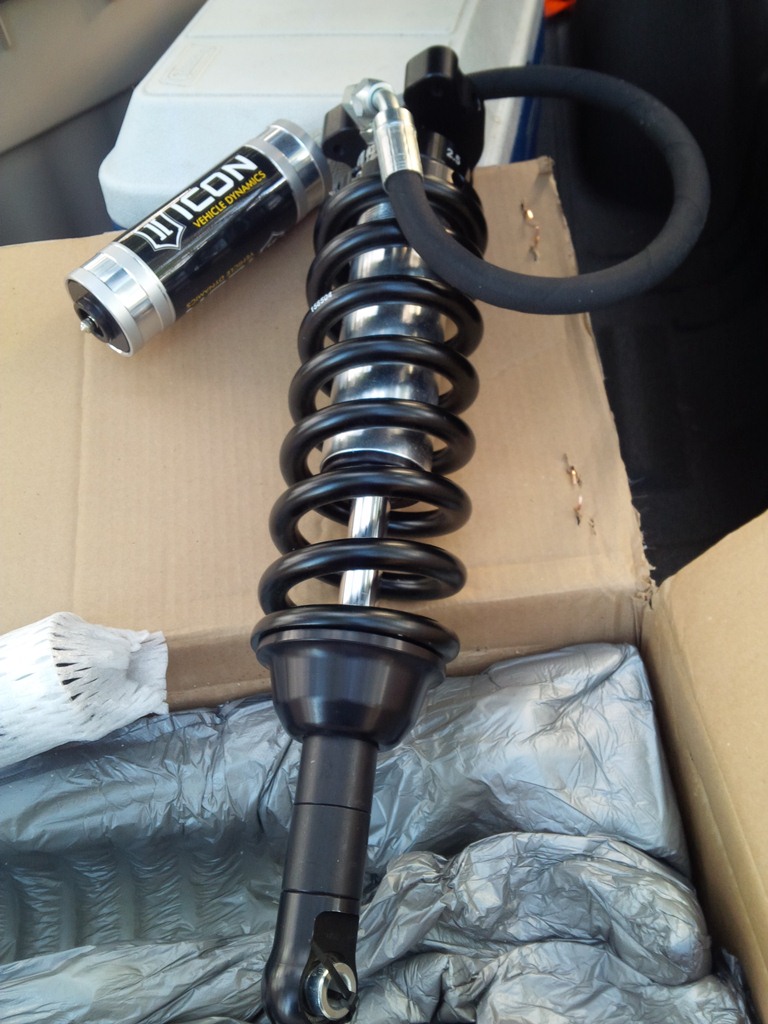

Bought some new suspension from Icon

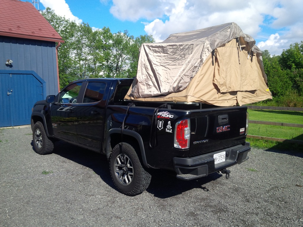

Added a rtt

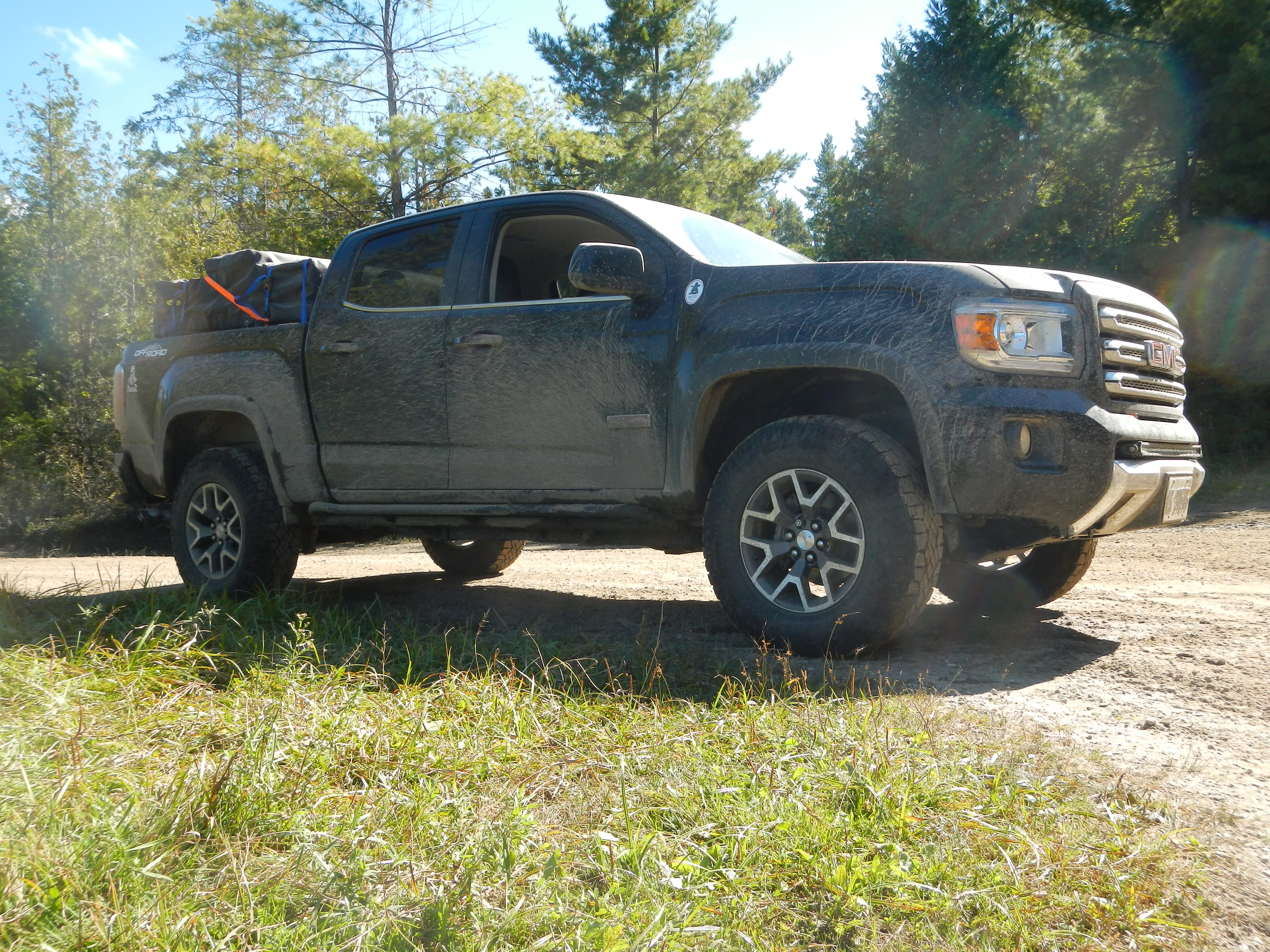

Just out enjoying life
Installed a RC 1.25 inch body lift. No complaints, still on the truck. Good bang for buck to get some tire clearance.
Put a RC 30 inch light bar into the grill

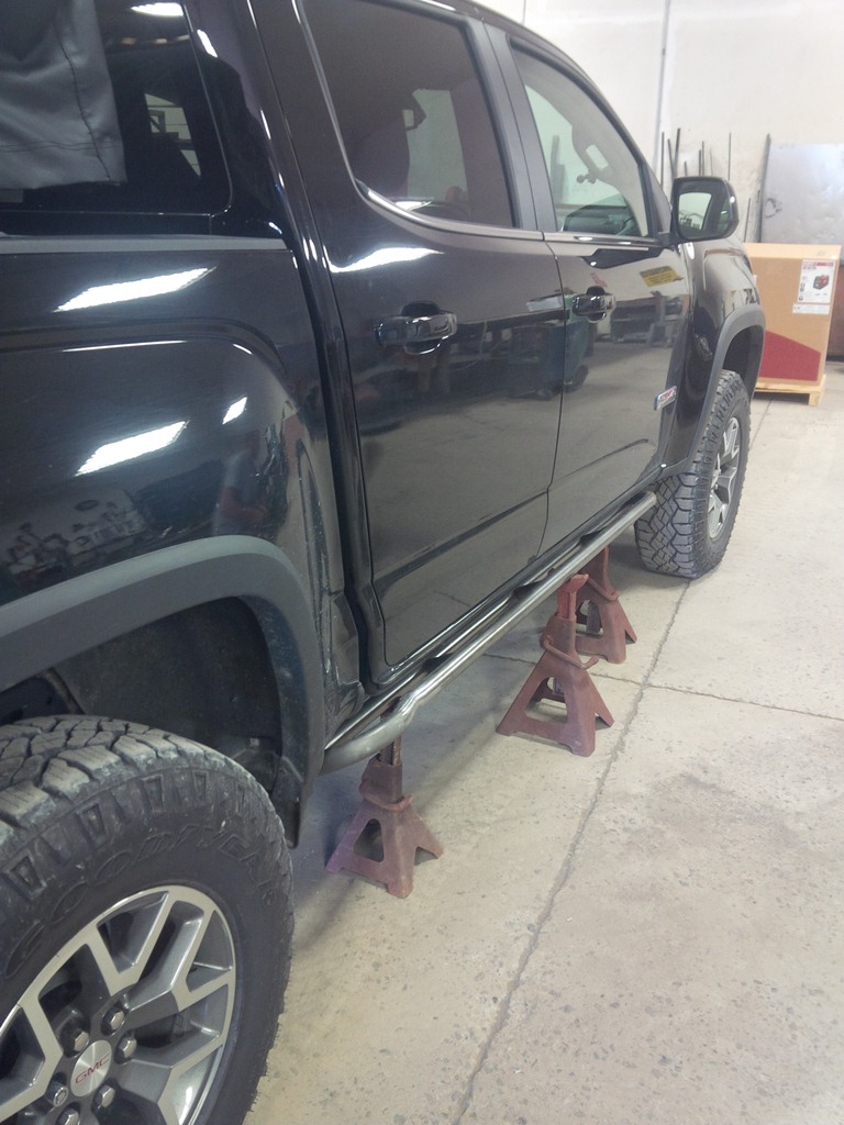

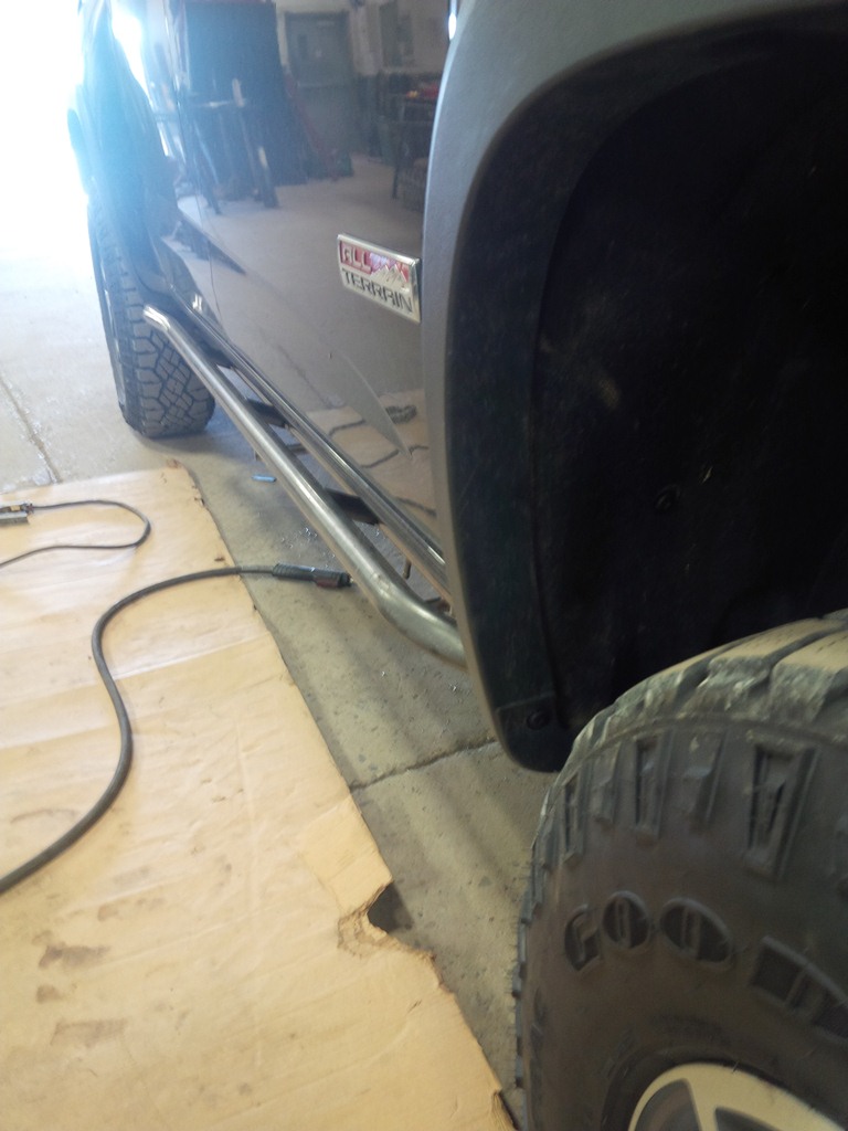

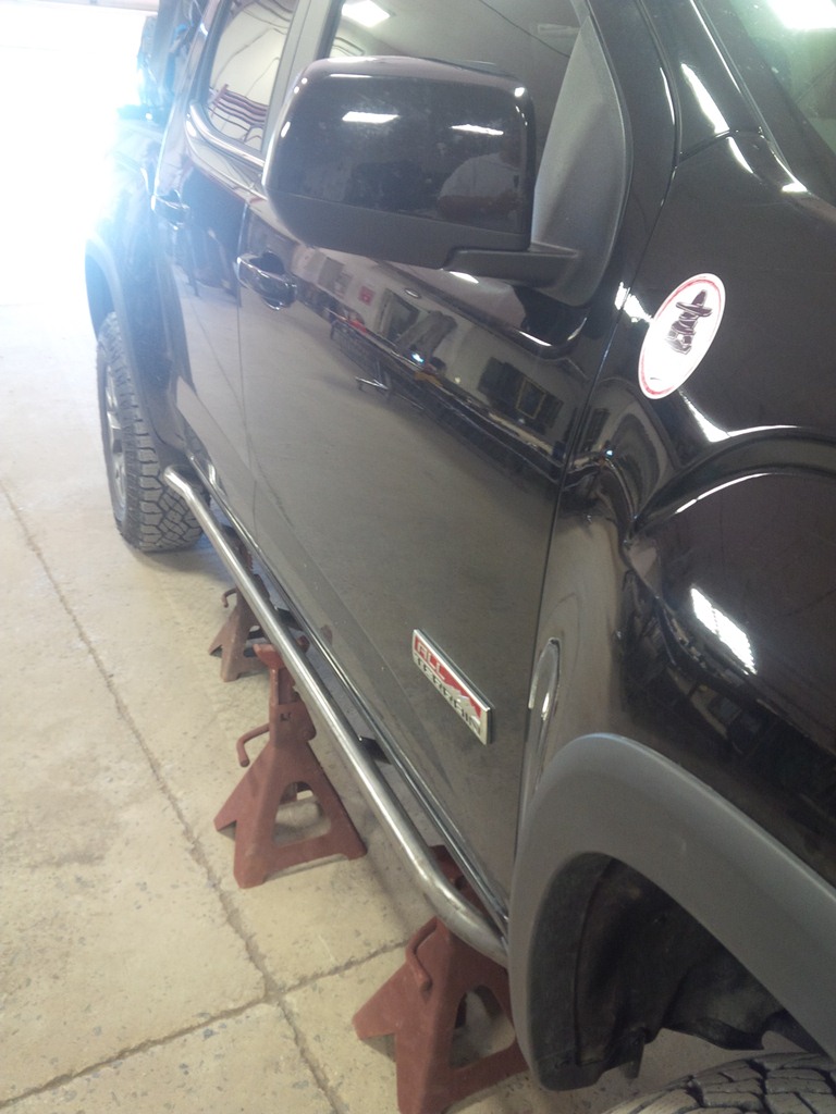

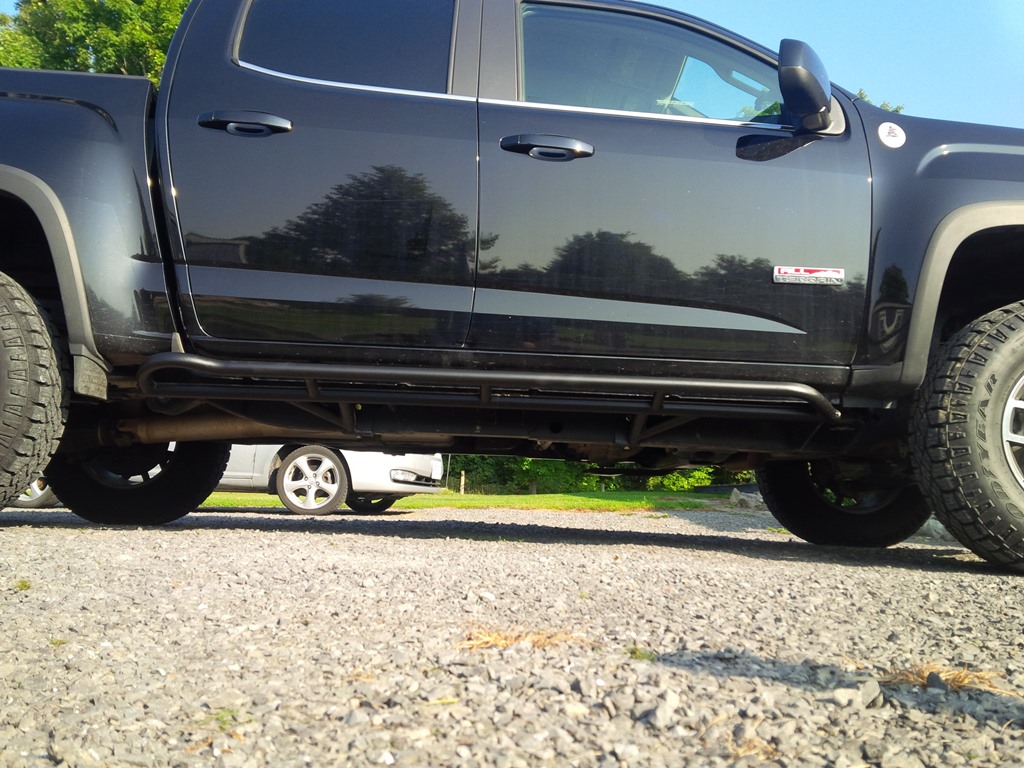

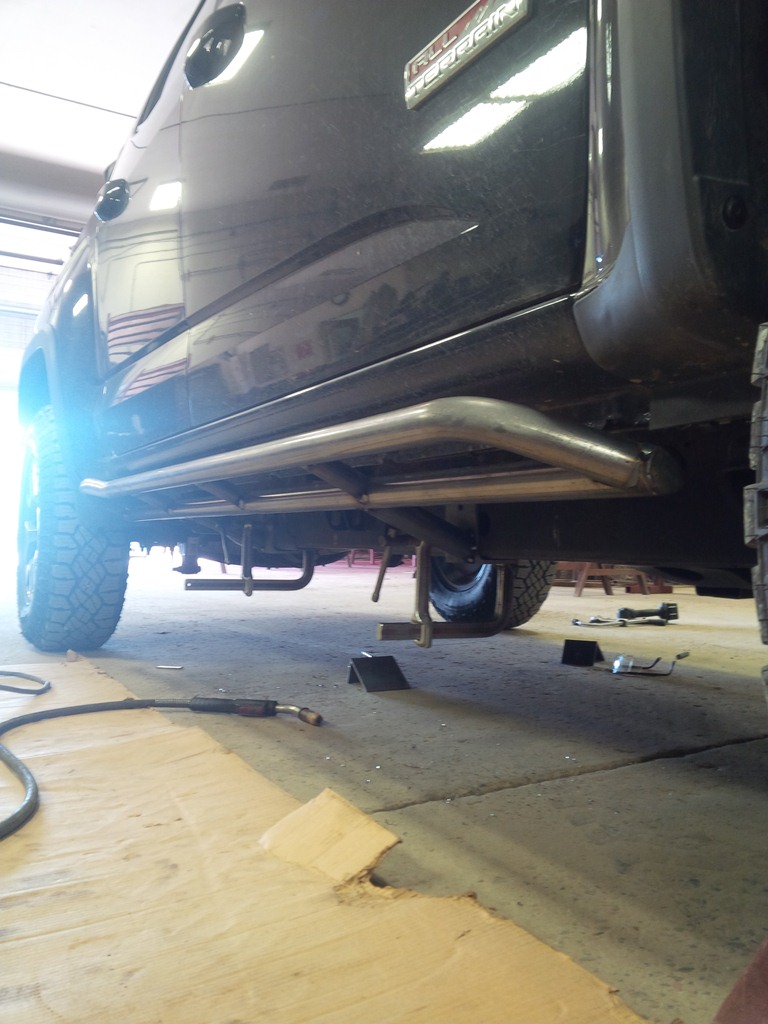

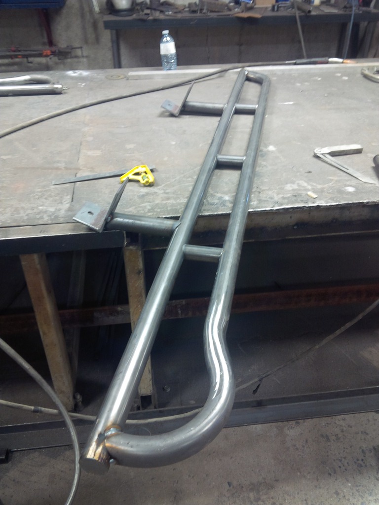

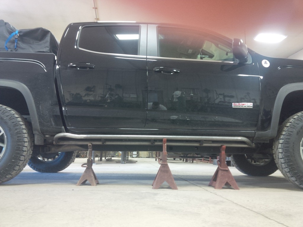

Had some slider made by a local guy
