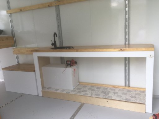

yeah, its definitely over built. its 3/4 birch framed with 2x4s and the counter top is five 2x4s planed and edged and then edge glued for kind of a butcher block look.
it has to be custom made to fit right, but even if i could go with the pre-made cabinets at home depot or lowes, i dont think they would last. and oddly enough, the price is pretty good. $80 for the sheet of birch and i still have a 96"x18" piece of it left to use with another cabinet and eight 2x4s...so $100 so far.

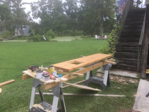

in the pic, you can see the little cabin i just built in the background (did a thread on here about it) and still doing odds and ends with, and the steps on the side are the detached garage/apartment i am finishing. so for anyone thinking about "retiring"...might want to rethink. i do more work now and dont even paid for it...:disappointed:
anyway...this is the 2x4 butcher block top that is getting stained and sealed.
the kitchen module is coming along and i have the sink installed and the tank/pump ready to mount. the bottom trim piece is left bare because i ordered tracks for sliding doors and i'll need to cut down that piece once i see how tall the track is so that it can flush up with the interior bottom. since i'm running 12v for the pump and a light, i also wired in a USB receptable so that we can use the open counter space to charge phones if needs be or plug in a wireless speaker, etc. i like having a good amount of USB ports around since that is pretty much the platform now for portable dc devices.
on the left is a chest storage that also functions as a bench and a step to get up into the bed. the wife is making a cushion for it and i'm sure it will host some type of weird pattern...
