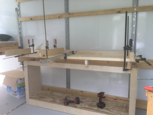

still plugging away...
by using the modified carriage bolts, i was able to mount 2x6s along the side of the walls. like i said earlier, the idea is to use the e-track to my full advantage, so by attaching the 2x6s, i have attachment points without poking holes in the finished interior walls.
first module is going to be a 6'x16" cabinet. it will hold a 15 gal. poly water tank along with a 12v sure-flo pump. the top is a butcher block counter top made out of 2x4 white pine. it will be cut out for a small sink and faucet and rest of the area will be for a portable stove and prep area. i considered installing a drop in stove, but the whole thing about versatility had me go with a portable 2 burner stove that can also be used outside. our current rv has a slide out galley and we really like cooking outside with it. on those few occasions when weather is too bad, we can easily set it on the counter and use it inside. im building the kitchen cabinet module where it is plumbed and wired and all i have to do is set it in place, secure it to the 2x6 runners and then hook up my power. the 15 gal tank in the kitchen module will also support the shower. i will plumb a quick disconnect to the end of the cabinet and all i have to do is connect to the shower with a hose and i'll have water for the shower.
