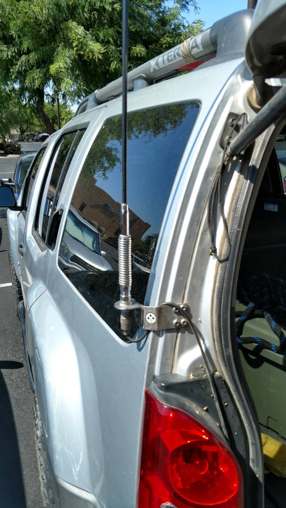

What mount are you running on the drivers side? I have a similar mount to your passenger side one on my Xterra but have been looking for something to hold hamsticks or even a 102" CB antenna.

Same thing, just lower. It puts the 1/4 wave CB whip at the same height as the UHF/VHF.

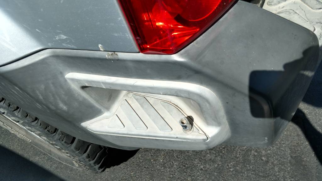

I played around with a longer whip with the mount on the rear step. I thought I could do this with tuner but could never get it to work very well on most bands.

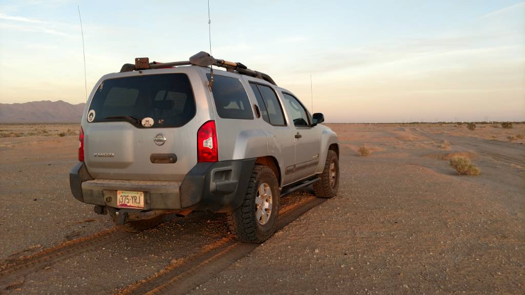

I took some pictures of the mounts for you.
