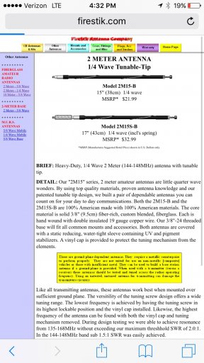

Can you use a fire stick for a
VHF/Ham Radio?
Or would you recommend getting something like a Comet Original antenna instead?
Firestick makes a Ham antenna. You can’t use a CB version for Ham.

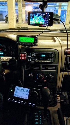

ICOM IC-7100 All band/All mode transceiver
Head unit
Main Unit with other electrical goodies

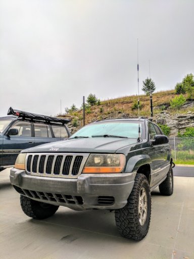

As for antennas
A dual bander VHF/UHF
And ICOM AH-4 mated with a whip that will tune from 40m to 6m ham radio bands + 11m CB radio
My rig but the whip was removed but you can see the spring
Good to see someone else running a 7100. I've enjoyed mine. I added a TM-D710GA for local comms/APRS when our club handles events or emergencies. Nice for the EOC to be able to see my location and they can also send messages direct rather than tying up time on the net.
This setup evolved without overlanding in mind, so I do need to re-think antenna size & placement. But this weekend we were out camping and while local 2m/70cm comms were completely gone, I was listening in on the Puerto Rico nets. That's the real reason I got into ham radio and especially HF in the first place. Knowing I can probably reach someone somewhere no matter what is a big comfort for me.
Not pictured are a Midland 75-822 HT and a Tytera MD-390 DMR HT with GPS. I like to be covered for whatever other people show up with.
