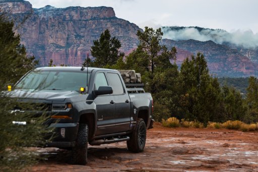

Changed my suspension to the Icon stage 5 (blew out my stock coilovers on mojave trail and broke my stock UCA)
This lowered me to a 3" lift from the 3.5" I was at. I need to now find smaller blocks for the rear as I have a decent rake in my stance now.
But I was still able to squeeze from 35x12.5 Falken Wildpeaks in there (with a little more wheel well liner trimming and a few zip ties. haha
Added a bit more light also...
View attachment 131678View attachment 131679View attachment 131680

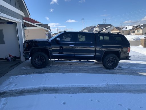

Los Angeles, CA, USA
Gomez

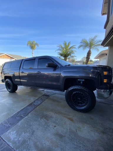

I’m on a 2inch leveling kit in front and 1 inch leveling kit in the back. My rims are 17x8 and I threw on some bfg 35s KO2 . I have a 2014 Chevy Silverado 1500 4x4 . I noticed it does rub a bit when fully lock wheel. So far so good . I’ll keep you guys updated. I haven’t cut anything. Here’s a comparison photo from stock general grabbers to bfg 35s
