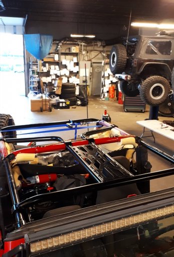

Not an "overland" mod but I figured a bit of extra safety wouldn't hurt. Once this next trip is done I plan to remove the basket in the back and put the back seat in again. Then again with the harness bar installed I may just leave it as long as I need this way. Stayed late and worked with a buddy from work to get a bolt in cage kit installed while he fixed some skid plates ( he is also included in the upcoming trip). 20200807_200036.jpg

Not an "overland" mod but I figured a bit of extra safety wouldn't hurt. Once this next trip is done I plan to remove the basket in the back and put the back seat in again. Then again with the harness bar installed I may just leave it as long as I need this way. Stayed late and worked with a buddy from work to get a bolt in cage kit installed while he fixed some skid plates ( he is also included in the upcoming trip). View attachment 166047
Impressive, I've thought about doing the front crossbar for years to hang radios etc from.
I still need to re-locate the radio up top and will need to extend my power cable to do so. I am hoping that I have enough coax to get it there. I'll probably find out today when I get into it again. I need to do the ball joints and wheel bearings and then stick all of my roll bar padding back together around the new cage so that it looks a bit more " factory".

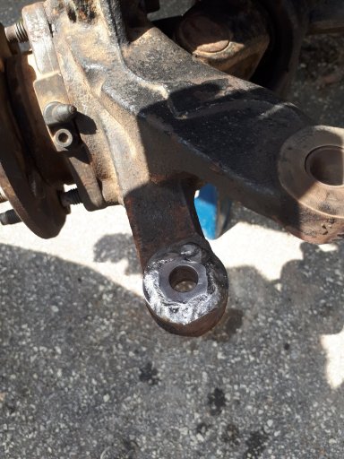

Well my last weekend go get the jeep ready for its weekend of abuse. Needed to change out ball joints, check bearings and a few other things. Found a crack in a front lower shock mount that needed to be welded up and found that one of the tapered inserts in the passenger steering knuckle needs to be re-welded because the tie Rod end is moving slightly in it and it has cracked apart from the knuckle.20200808_112253.jpg20200808_103457.jpgreceived_735999927252606.jpeg

Found both of my tapered inserts had broken loose from the inside of the knuckle and needed to be re-welded. I am hoping these last through next weekend with my cheapo welder. It's earning it's keep this weekend. Drag link and tie rod inserts removed ground down and re attached and it drives like butter again.20200809_112823.jpg

Everywhere is different but many jurisdictions ban welding, cutting frame rails, steering components unless it is done by a Journeyman Welder, seeing these failed welds, the reason is obvious.
