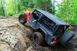

not having any close friends who actually go out wheeling to go camping, and really only camp if they NEED to. I ended up going for more day trips than weekend camping or long trips out. so They Jeep turned into a more of a crawler.
I swapped out the axles and put a Dana 44 in the front with a high steer, e-lockers front and rear, 37" tires and took it from north or Toronto out to Rausch Creek offroad park for a week.

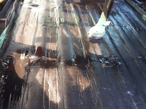

I decided to lay down some sound deadening to reduce as much of the noise as I could. did the front and rear floors ( only took pictures of the rear) and then sealed it in with a layer of bead liner. I have to say it doesn't do much to reduce the exhaust noise from having next to no exhaust, but it got rid of a lot of the rattles and echos from in the cab. I put all the carpet back in after it was dry and was fairly surprised. it was a 150 mil closed cell PE foam liner so it didn't add any weight to the Jeep and it helped a little with heat over the trans tunnel but not as much as I was hoping for. I may try to run a bit more of an adhesive foil layer over the trans tunnel but the console is a pretty tight fit as it is.102895328_263408168339531_5449973122056242320_n.jpg101707514_867952313726363_517233375282855500_n.jpg102453366_182987876425578_8858740447547092632_n.jpg
