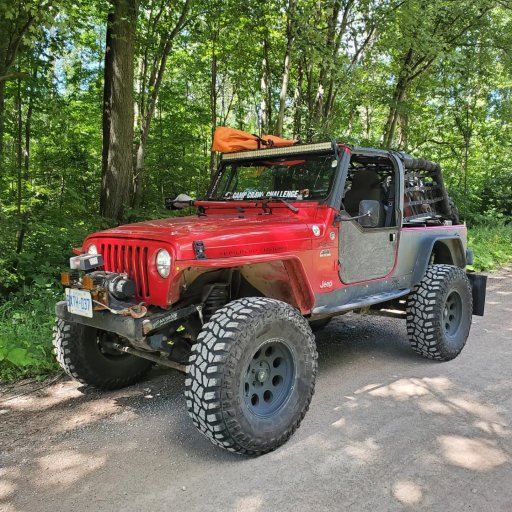

The next day we mostly sat around camp and enjoyed the sun. But we did manage to get out and run some nearby sections of trail.View attachment 207127View attachment 207128View attachment 207129
My jeep is kinda cursed, there are never many pictures of it so this is about all I have lol. All in all it was a great weekend.

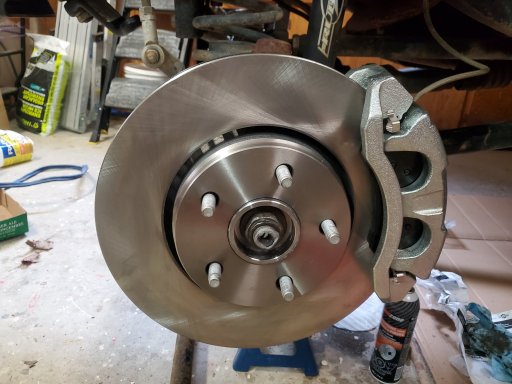

what I did do was address some brake issues I had. Part from neglect, and part from trail damage. The brakes were worn and after getting stuck in a bog on one trip and a long under the mud doing a lot of damage to the underside around the rear axle (broke/bent both rear shocks, tore the rear locker wiring, had rocks stuck in the rocks under the mud so the rotor was grooved, bent a rim).

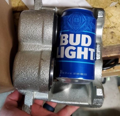

Unfortunately, not having the connections I used to have and the Transamericain Wholesale company being sold, and their product lines in limbo on what was going to be liquidated, parts were hard to find. I decided to change the entire system out to the Crown automotive big brake kit which allows me to replace future parts with Ram 1500 brake components. It also comes with a pretty beefy set of dual piston front calipers ( the ones found on most Ram 1500s).
I will say these calipers are HUGE in comparison. Especially if you consider the original dinky TJ calipers that came on this thing.
One thing i did notice was when I pulled wheel off the drivers rear... things didn't look right lol. The pins were bent somehow, assuming that they seized and the caliper folded them over ( while I was driving I thought i had a dead caliper).
However with everything being swapped out anyway it wasn't a big deal and these new brakes look great.... I am hoping that the master cylinder won't have any issues with the upgrade....again these calipers are huge! Lol.
