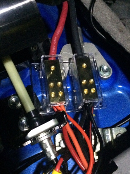

...I do eventually want to completely rewire all my accessories to run off two circuit breakers - one that will have power pulling front the battery all the time and one that will only have power when the ignition is on. I'm holding off on that until I can install a dual-battery setup and get everything pre-wired for roof lights.
This is under the center console, next to the automatic shifter.
4AWG power and Ground, fused with 100A fuses at the battery. The four outputs each run a radio.
  1. Anytone CB
  2. Kenwood TM-D700 (VHF/UHF)
  3. Kenwood TS-480Sat (HF)
  4. Byonics MicroTrak RTG (APRS)
I'm going to be picking up a Blue Sea Systems 12 circuit fuse panel to manage my accessories, however the radios are unlikely to be changed. The only other option I've considered is an NSA box from Trail Toys. which gives me 8 circuits under the hood, with an RF remote control. Either way the radios are keeping their 4awg feed.
