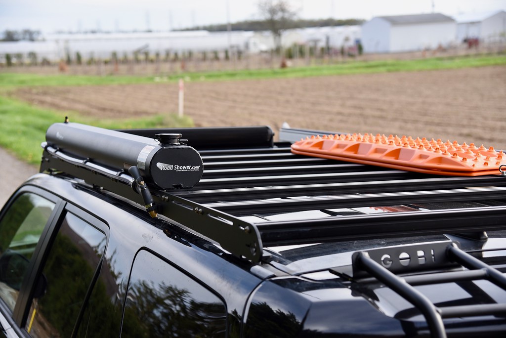

Road Shower 2: That's cool. I really like the way the hose clips to the side, but I would like it to loop back around the other side as well to have double the hose length. That would be the only thing that I would change.

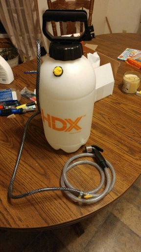

I like to keep it simple I use something like this when we camping out of the rig
when using the camper trailer just a 20L drum with a 12v pump. Boil 5L of water out of the drum put back in the drum perfect temperature. 20L do two people
I have the same setup...$27 including the kitchen sprayer....we use it for washing pets..rinsing off sandy feet..works really well..

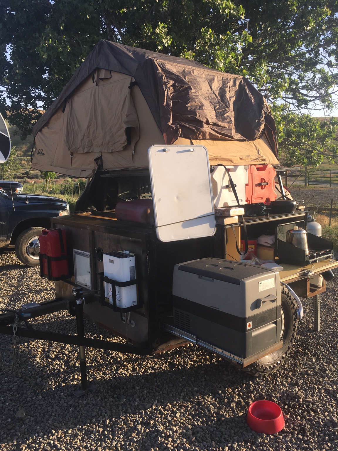

I am using ecotemp. Has worked well for the limited use I have on it.

With this type of water heater, what happens to water temp if you turn water flow off and on during your shower? Does it remain pretty constant or does it get too hot? Seems like a good solution.

When water stops, gas turns off. It senses water flow and turns back on when water is turned back on. 2 D batteries supply power for the igniter. Very cool set up. For my sink, I have no cold water set up. I just adjust temp on heater. For cold water, just turn it off. Simple simple

Mine is set up with a water pump and pressure diaphram. I have a 30 gallon tank under trailer deck. I used the stainless steel wrapped hoses ( like youd find for sink supply lines) and from pump to heater i used a washing machine stainless steel hose. Items can be easily picked up at hardware store on the road if theres a failure.
