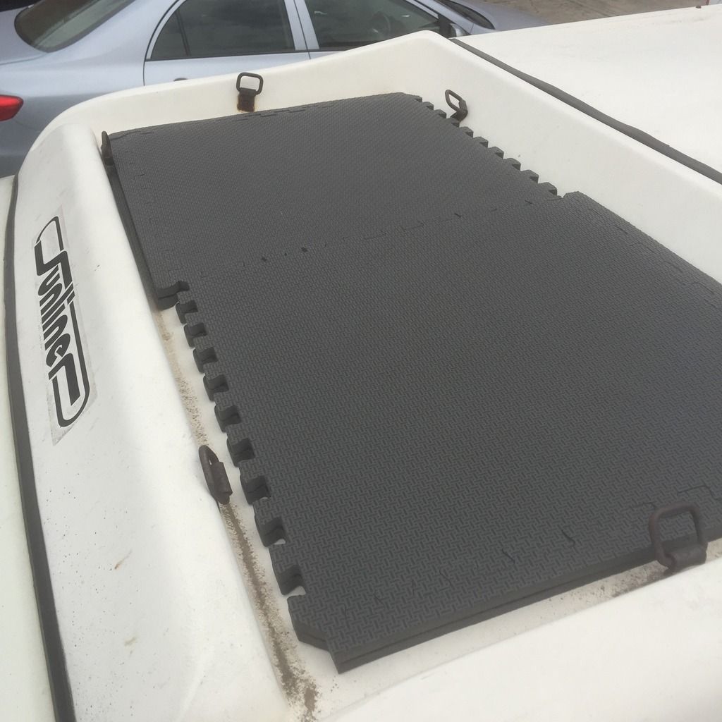

So did this. Padding not to crush my roof haha

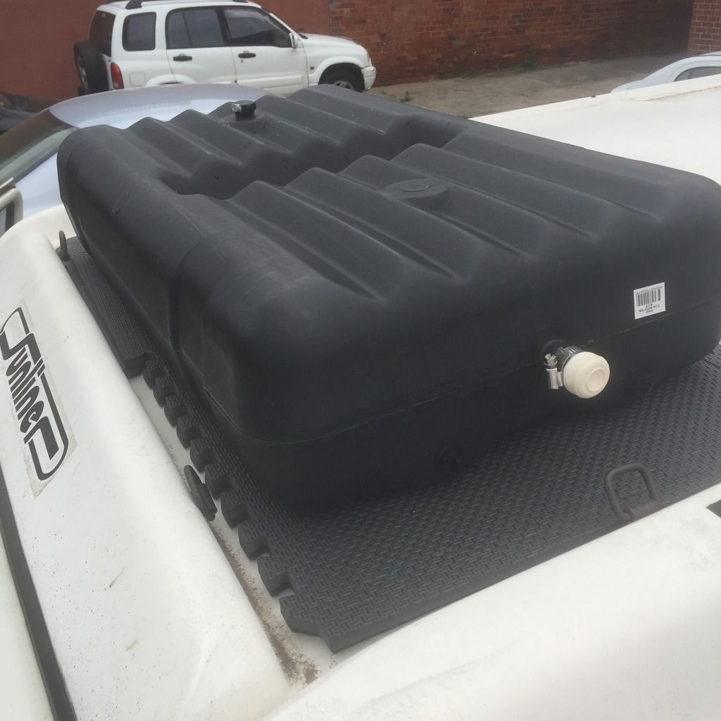

Then from bunnings bought a black water container. It has perfect size plug holes for a hose attachment.
Plugged the end. It holds 60 litres. Ive had about 30 litres in it. In the Australian sun and also when driving it really heats up quick. Then from that i siphon to a bucket. Then use this set up along with a 12volt car shower. Simple
Possible a little bit of overkill. But nothing beats a warm shower after a long drive etc.

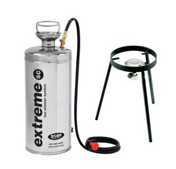

I'm surprised no one has mentioned the Zodi. It's self contained, dead simple, requires no power and holds enough water for two frugal showers or one luxurious shower. Only downside is it doesn't "bolt on" to the rig, but if you can set up a skottle you can set up one of these. I have one and it works fantastic, heats up fat keeps the heat for a loooong time, and has a built in pump and temp gauge. I used it for dishes too. I've seen folks put a different tube on it with a kitchen sink sprayer so you can control the water flow at the head instead of at the tank.

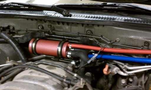

I run a heat exchanger and pump under the hood with an on and off switch.
Have the pump connected to hydraulic quick disconnects. And it's plumbed into the trucks heating/cooling for heating water that runs through the exchage.
I connect hose to one end with a filter, toss it into water source, bucket, creek etc. Start truck, power on pump.
Connnect to other end a shower sprayer. In about 2 min I have 110 degree water and it gets warmer. Controlled by heater controls in truck.
Use to have a valve for cold/hot, but to much hoses, so I removed the valve to make it more simple.

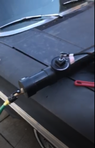

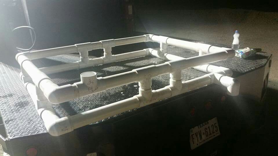

I built a shower out of 3" Black PVC and used it on my latest trip. Worked great. I have a small 12v bicycle pump connected to it and it pressurizes the tube. The water pleasure is great and the sun hitting the black tube during the day warms the water nicely. It also worked for washing dishes and rinsing off all the desert dust off my truck. Not sure if I can post a video.17264599_10208978363751891_2144151420033869718_n.jpg
