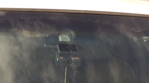

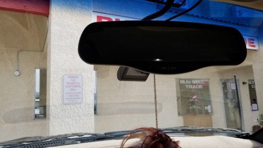

Well, early into last summer the G1W-C dash cam I was using ate another MicroSD card, and then promptly stopped working altogether. All in all, I was rather disappointed because this little booger has had plenty of issues over its short service life. After research I replaced it with an Anker Roav C1. Anker is quickly becoming my favorite accessory store, as their warranty and customer service is unparalleled. I'be bought other things from them, and I was pleased with the features these dash cams come with. You don't have to actually remove the MicroSD card to access video, as the cam has Wi-Fi built in, just open the app and go! Picture quality is pretty great, too, so that's a bonus.
As seen from outside. it's low profile form sits neatly behind the rearview.

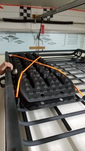

I've also picked up a set of OFFROAD BOAR traction boards. We'll see how they hold up in time. I can say that I'm mighty curious myself. They seem pretty dang sturdy, but if they work for the $80 I spent on them, I'll be pleased!

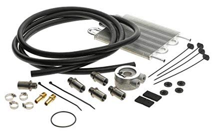

Well, the last week has been full of excitement and Jeep mods. Last weekend I had a chance to install the Hayden 459 Ultra-Cool Engine Oil Cooler Kit.
Even though 459 is the PN for the "Light Duty" model, I believe it is sufficient for my application. I wanted to see if I could pull some of the heat out of the oil, further reducing strain on the cooling system. Cooling the oil should also improve the long term lubricity of the oil (I'm thinking about crawling here). I've found during my torture tests (Highway driving, slow urban driving, and everything in between) that as the vehicle temp raises, the oil pressure is a bit higher overall, though it never dropped below the normal "40." During this install, she got a fresh filter and an oil change. She's a happy girl!
Overall, not bad. Cooler installs with nylon plugs, kind of like zip ties. I bought another set of those, just in case.
