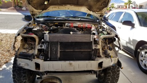

Well, I recently had the experience of walking out to a leaky radiator again. I had been preparing for this for a long time, as it isn't the first radiator this rig has gone through, and I've put a ton of abuse on this cheap $60 RockAuto rad in the last 5 years. So, as usual, I did something experimental.
I upgraded to one of those "full aluminum" Radiators you see on the internet, but few have actually invested in. So, Let me tell you my first impressions. It seems to be made pretty well, and all of the welds look pretty professional. It is dual row, as compared to the OEM Single row, so it is thicker, and the mounting brackets have been welded accordingly on this design. It also holds about 1.5 QTs more coolant than stock. The radiator doesn't stick any further into the engine bay than before, however it does stick further towards the grille slightly. If you have the OEM auxillary Transmission cooler on the front of the rad, you will have to modify the metal lines to make it fit correctly in front of everything. I have only two complaints, which are both pretty minor. Firstly, the new radiator came with no hardware whatsoever, except the Transmission cooler studs. Everything else had to be swapped over. The other one was that the suds on the bottom of the radiator that slip into the lower radiator support, are actually about 0.75" too long. I had to cut these to fit correctly. I also had to cut down the rubber bumpers these studs fit into so that I could bolt down the radiator. This radiator if physically taller than the OEM. You also have to make a small cut to the Upper radiator support so that it doesn't contact the radiator.
Oh! you also have to trim the bottom of the fan shroud to fit correctly, otherwise it was an average, PITA WJ Radiator install.

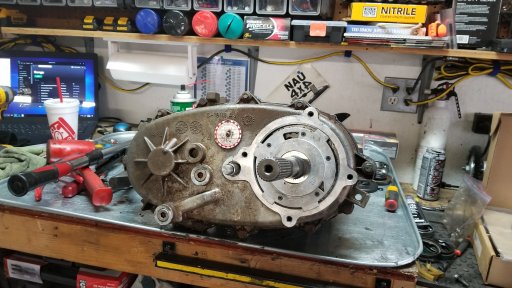

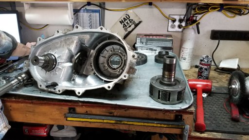

Well, Today was the day! What day? The day I returned home from a much needed Transfer Case swap. I drove down Friday morning, and we promptly got the Old 247J out and broken down.
We found some interesting things in the old 247J. One of the tasks was to pull the input shaft and planetary gear out to swap into the 242 We were rebuilding. To our discovery, we found that the 247 had the extremely elusive and uncommon 6 gear planetary! Anyone who has rebuilt these knows that most generally come with a 3 gear planetary, which is standard in the 247J, 242J, and 242HD. The 6 gear is far more rare, and generally only used in heavy-duty scenarios, generally only found in the Dodge commissioned Transfer Cases. 20180105_145836.jpg
After promptly cleaning out the guts of the 242, we replaced all the seals and bearings. Pretty quickly we had it coming together.

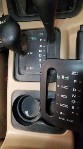

For those who don't know what differences the 242 has over the 247, the bezel in my hand here is the one which will be replacing the one actually on the shift console.

Well, Today was the day! What day? The day I returned home from a much needed Transfer Case swap. I drove down Friday morning, and we promptly got the Old 247J out and broken down. We found some interesting things in the old 247J. One of the tasks was to pull the input shaft and planetary gear out to swap into the 242 We were rebuilding. To our discovery, we found that the 247 had the extremely elusive and uncommon 6 gear planetary! Anyone who has rebuilt these knows that most generally come with a 3 gear planetary, which is standard in the 247J, 242J, and 242HD. The 6 gear is far more rare, and generally only used in heavy-duty scenarios, generally only found in the Dodge commissioned Transfer Cases. View attachment 44279

It was terribly surprising to find it in a "medium duty" transfer case (that's what the 4 in 242 and 247 means) which shouldn't really have more than 3 from the factory. I'm guessing the day this junkyard t-case was produced, The factory must have ran out of the standard 3 way planetary gear, so maybe there are others out there! Or, possibly it was previously rebuilt by someone looking for a slight more durability, although it seems improbable that someone would throw one of these in a case such as the 247 which is so incredibly failure prone in other areas.

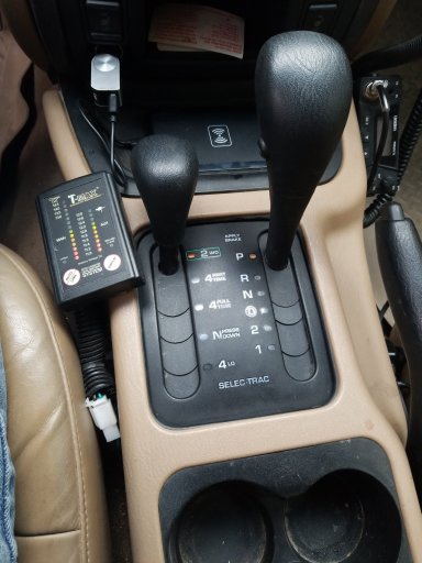

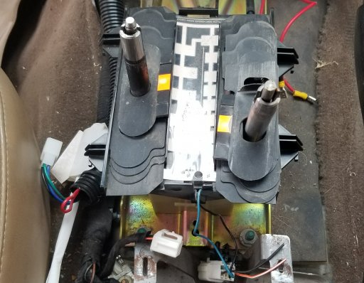

Well, the fun doesn't stop there! I only bought the shift bezel, so I had the especially ...fun * cough cough* task of pulling the old shift bezel. Lots of pulling. But eventually it will release and you can pull the shift bezel.
You have to cut the OD wires, as the shift setup isn't really designed to be dismantled, although also it is directly designed to be dismantled if you look at how its assembled... if that makes sense. You do have to reconnect the OD wires after your done.
Once you take the old bezel off you just pop the new one on, piece of cake!
Although I do say it came out well, an issue you have to be mindful of is that re-using the 247 shift assembly, you don't have the Neutral lockout the 242 shift assembly has. you just have to be mindful not to bump to Neutral unless you have the transmission in neutral. 4 BT and 4FT are both on-the-fly shifting. and all, well, 5 work just fine. A little stiff at first, but as fluid starts pumping, and it's now fully lubricated, everything works smoothly. I'm very pleased thus far.

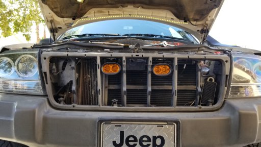

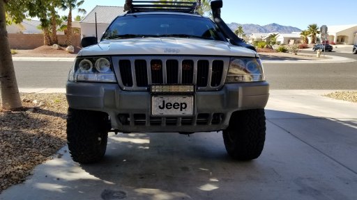

In the meantime, I added something which I have been planning for a long while Over the last year and a half, I've been planning to drop a pair of Amber LED fog lights into the front grille and have them run off the fog light circuit already integrated into the Jeep's "Light control/blinker" stick.
I wanted some nice bright ambers, as I don't usually encounter fog, but when I do it's as thick as pea soup. These won't be on all the time, but they'll be used when their needed. These weren't spliced in, but rather I make a proper wiring harness with the OEM pigtail on each side. Oddly enough, the posts of the pigtail were reversed, so I had to take the time to dismantle the pigtail and switch the wires around.
All in all it came out exactly how I wanted it to. Clean, out of the way. Haven't had a chance to try them at night though, but I was able to align them using the garage door. Hopefully I'll have a pic or two tonight.
