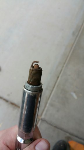

Well, I've spent the last two or so weeks diagnosing an injector circuit malfunction on Cylinder 4. I was finally able to get everything tested, and found the I actually had a bad injector, and that 2 others were on their way out too. Of course, simple replacement is not my style. Time for an upgrade!
These little beauties are Bosch (Gen 3 I think) Fuel Injectors. They are pretty similar to the OEM Injectors, except for the 4 Hole (instead of 1 or 2 hole) design. The 4 holes supposedly provide better fuel atomization, for a better burn of the fuel. While I was at it, I replaced spark plugs, which is something I was about 20K overdue for.
The plugs were replaced with NGK V-Power plugs. She runs and idles much smoother now.

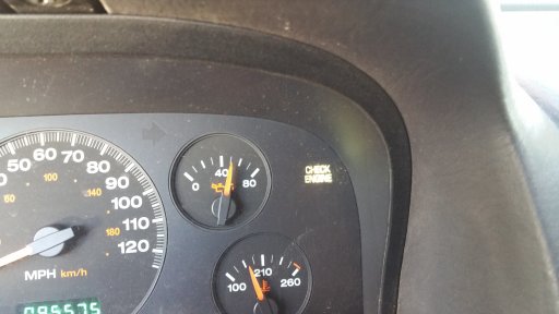

So the TPS (p0121) code continued coming back. Regardless of anything else I did, including swapping in a new Mopar TPS, and even a new Mopar MAP sensor, the code absolutely won't go away. I Replaced the TPS plug as it was worn and wobbly, and still no dice. Pulled the Throttle body, and scrubbed until it was shiny and clean. No dice. I began to suspect the ECU/PCM, and my fears were realized when I went to start it Saturday, and all it would do is start and then die as soon as you pushed the throttle any. New ECU/PCM should be here tomorrow, hopefully it's the right one. What do I mean by that statement? Well, the 99 WJ it appears, used a different model ECU/PCM than the 00-04 WJs did. My WJ seems to share an ECU/PCM with the european WG grand cherokee. It seems in 1998 they were in such a rush to strap the first model year together (for 99) that they likely just strapped it on the rig and programed it for US settings.... Or did they? My rig, despite having a considerable lower mileage than most, has always been "Gentler" on highways than my friends rigs with the same engine, larger tires, and more lift. I'm curious as to what the newer, US model ECU does to it.
Of course, Cardone Industries is the company re-manufacturing the ECU/PCM for the rig. With any luck, it should be here tomorrow morning.

So the Jeeps back, $1200 later. It starts, it runs, it's driveable.
But the P0121 persists. It barely gets up to 45MPH, as previously. But it starts, so there's that. Back to square one. I'll have my (non dealer) mechanic look at it.

Well, I'm pleased to report Pegasus is back from the mechanic. he really is the Jeep whisperer, as the jeep spat out several DTCs at him. A new CPS was necessary, but also we figured out what was causing the P0121 as well. When I installed the snorkel, I used 2 single ply non-reinforced silicone elbows in the setup. Turns out they were collapsing under the vacuum caused by the open TB, causing the PCM to get confused and think that the TPS was bad. The reason she ran like s**t, otherwards was suffocation + lack of timing advance.
In other news, the Jeep is running better than she has in a long time. I got her up to 65 easy on the road and she could have gone faster had I asked her to.

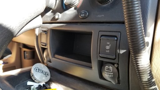

With the Jeep running well, I was able to buy a part I've been eyeballing for a long time. A quick message and small payment to an online junkyard and Viola!
The Pseudo-ashtray has been swapped with the 2004 style cubbyhole. Probably the easiest swap in the Jeep (probably).
