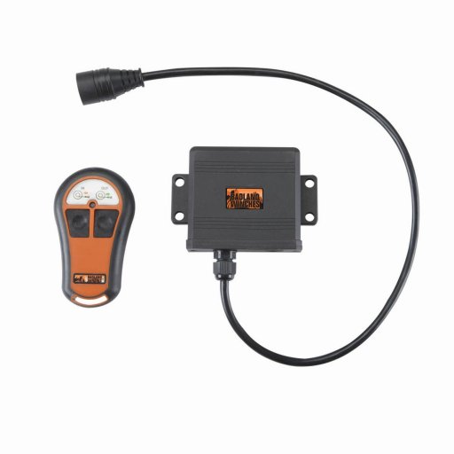

Harbor Freight sells a wireless remote control. I went the other day and took a look at the system. My feeling is that the winch will perform better with a hard wired controller. The wireless system seem like there could be a down side on the trail mainly the (loss of battery power in the remote).
I got the wireless system....trying to figure out how to mount the winch in my 4Runner figured the wireless system may be the best bet for me.
I was thinking of buying it. When I went to look at it I realized that I didn't have any more room to mount the wireless box and the remote didn't have a battery level indicator.

The controller box is the only thing about the Winch that I have not been fond of. The box it’s self is fine. The cables to the battery run directly out of the back and don’t have room on the Jeep to go down behind the Winch. Therefore they had to be run through the grill.
My feedback is that with a remote mounting location or having the cables run at 45 degree angle this would be the perfect Winch for the price.
