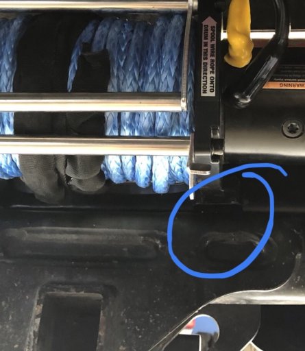

The rear winch is mounted “feet first” meaning the “bottom” of the winch is actually the facing backwards and it’s where the cable is coming out.
It’s bolted to some 2x2x.250 spacers to push it back from the bumper plate so the cable angle isn’t so extreme.
You can barely see the spacer here.
