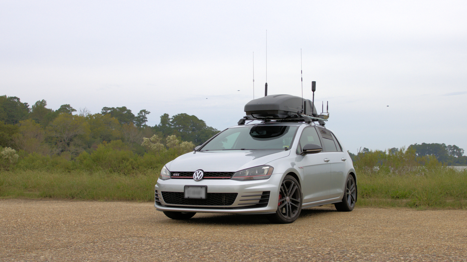

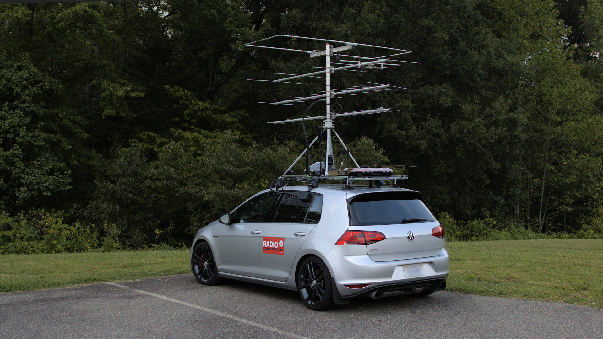

I'm removing the cargo box tonight so that I can prepare for a radio event this weekend. Soon, my "micro-tower" will be up and ready for the road...
The hitch-mounted antenna is part of the reason why I want to carry an external box on the roof. The antenna prevents me from opening the hatch. Yes, I can remove it when I really need to (as I did for a flat tire last year), but I'd like to have a few things easily available if I don't actually need to unload the car.

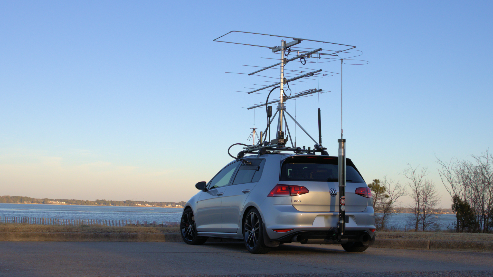

The rotating antenna array, mounted just 4-6 weeks per year, is part of why I don't want too much additional weight on the roof. Believe it or not, the roof load with that thing up there is still less than 60 lbs. I do need to change my driving behavior, though, since the tall load can add a cantilever effect at the roof rack mounting points.

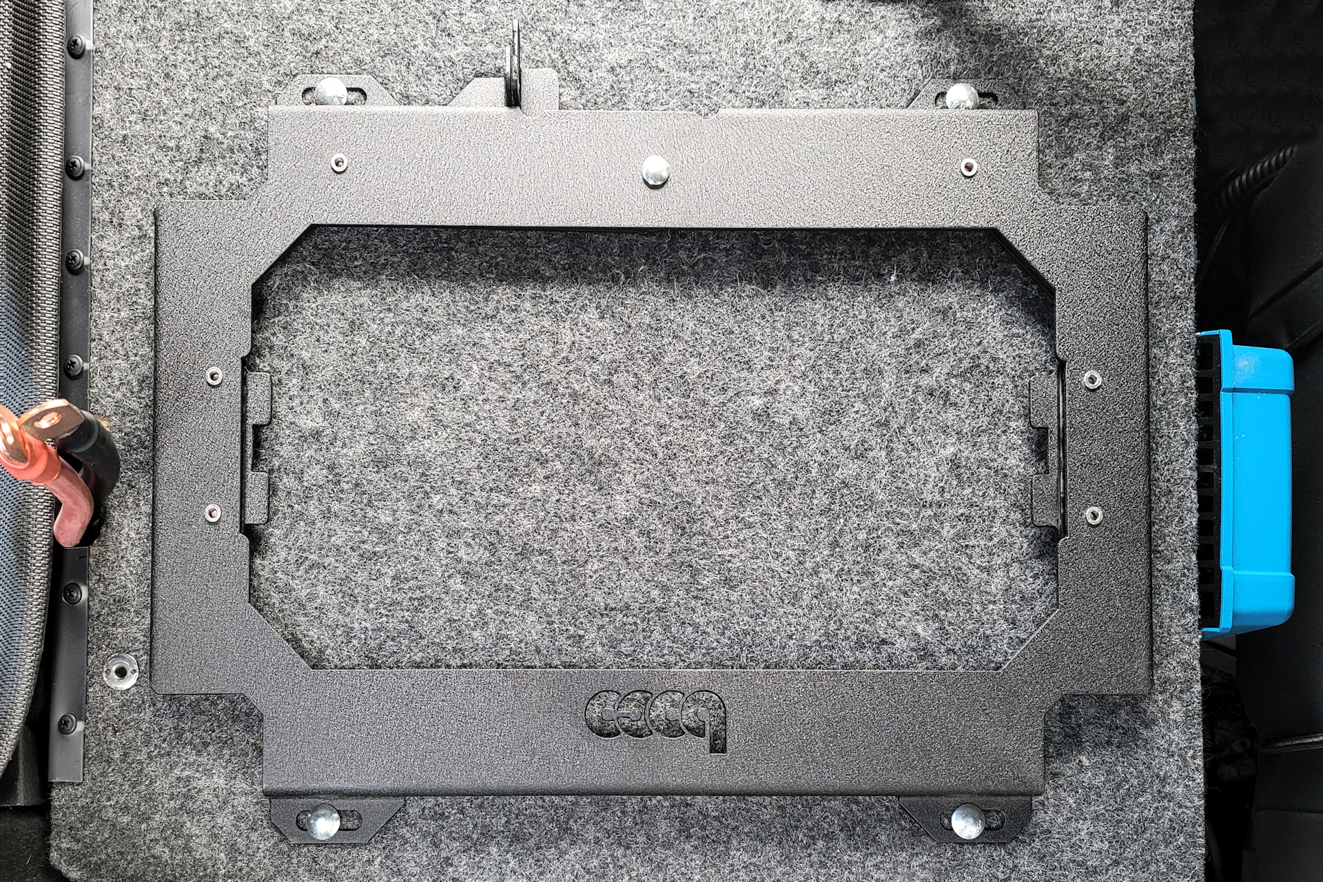

Coincidentally, I figured out what I'm going to start with as an experiment. I'll add another "crossbar" (no additional supports) ~15 inches forward of the new crossbar so that I can use this Boco Custom lockable mount to hold a Husky Build-Out case.
I'll weigh whichever box I plan to carry to ensure that I keep it less than 35 lbs. I'll share the end result when I get there. Thanks again for the ideas and thought process!

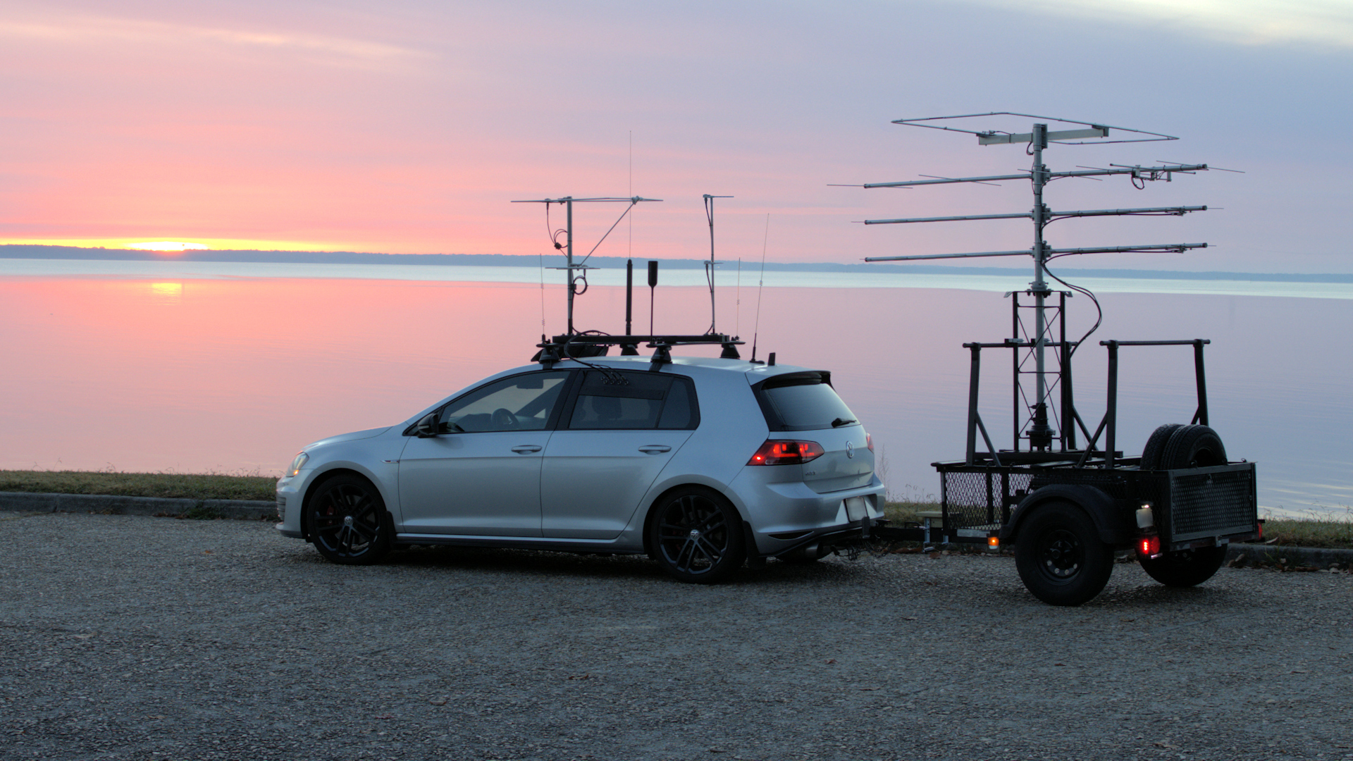

I actually have two trailers -- a 3.5x5' utility trailer and a 4x6' cargo trailer. I built out the utility trailer after my roof rack suffered internal damage from a heavier tower setup:
It worked well, but I ultimately removed it after just one weekend of VHF/UHF activity. Some of you already know that backing a small trailer in the dark can be a challenge. Well, the type of radio operating that I was doing that weekend requires some maneuverability. I can be a bit of a magician at putting that trailer into small places. BUT doing it in the dark is my nemesis!
In the end, I built a lighter setup for the roof so that I could have the most nimble platform possible. BTW, the antennas mounted on the tower are 6m, 2m, 222, and 432.

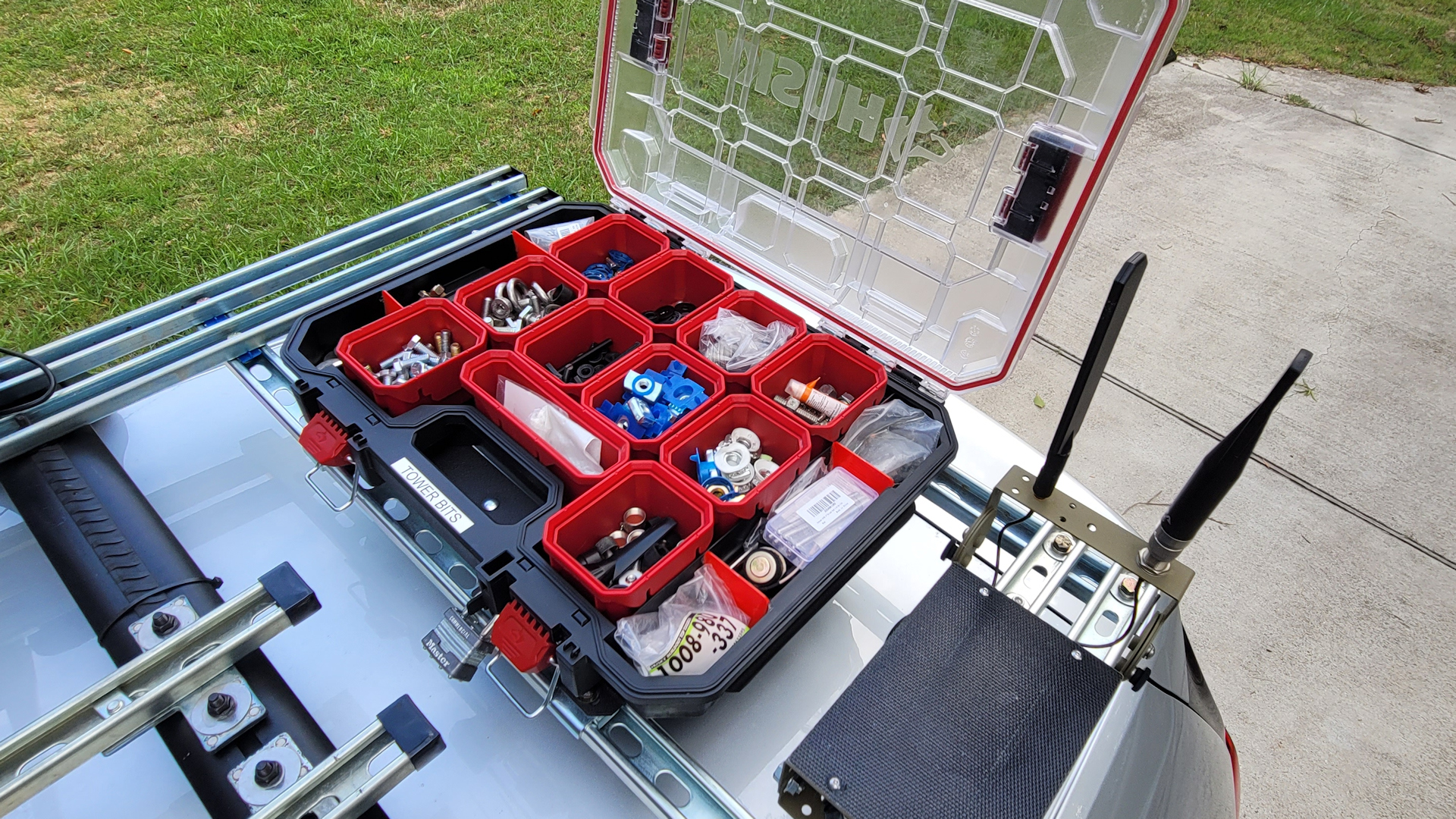

On topic, I finished installing and testing my small box solution before I need to mount my micro-tower this evening. Here's what I photographed as proof of concept:
The Seasuckers did exactly what I had hoped -- They made a fairly solid third crossbar into a very solid one. I'll still limit how much weight I carry back there, but it's good to have options. Coincidentally, I guess I now have a bar on which to mount a compact "chase light" bar that can light up my driveway and perhaps make backing that small trailer just a little easier. :grinning:
