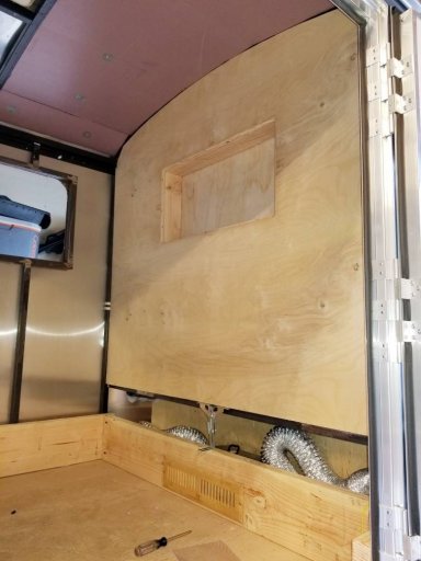

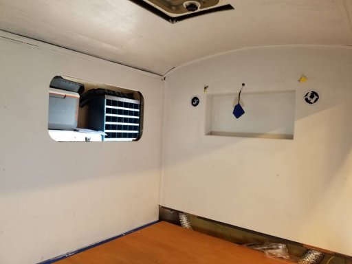

Little more progress. Walls are in, front wall is in. The black circles on either side of the cubby are the ducts for the heater (inlet and return). The little box hanging in the middle is the thermostat. On either side of that is wiring for the light and 12v outlets. Btw, the ratcheting truck bed divider from Harbor Freight is super handy for lending an extra hand to hold stuff, lol20190419_165343.jpeg20190419_135547.jpeg

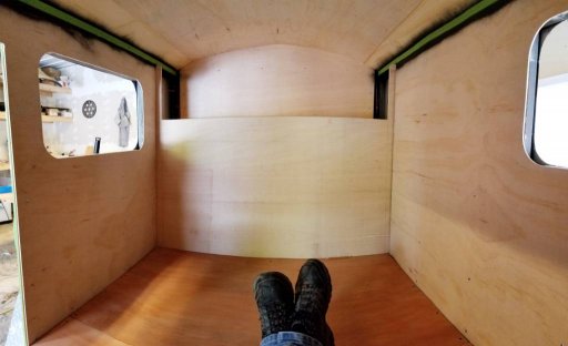

Rear side walls insulated and covered, top shelf in, hopefully tomorrow I'll get the rear bottom shelf in, and finish the trim, and primer the next day. 20190503_195937.jpeg20190503_195948.jpeg
