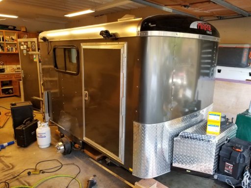

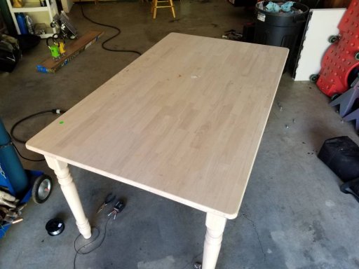

Little more progress. Started making a temporary bed frame with leftover wood from my shop build, and bought a $10 table from the habitat for humanity restore to canibalize. Going to cut the table top down the middle, install a piano hinge, sand it all down and stain it black. The table will be hinged off the trailer side. I need to figure out how to make an adjustable leg for the table that is removable, not sure on that one yet. The table will fold up and live on the trailer wall outside (will mean having to clean it all the time but it'll save us space).
I also decided to shrink the bed size down to a full/double. The inside of the trailer is 56.5" wide, and a queen is 60". Full is 54", but also shorter being 74" instead of 80". That'll give us more space at the back of the trailer which is at a premium in this tiny thing. 20180926_111641.jpeg20180926_123738.jpeg20180926_143315.jpeg
So I'm having second thoughts about the side table, mainly due to road grime and complexity. Not sure if it'll happen.

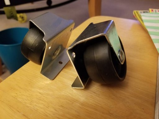

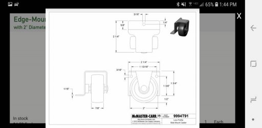

I did though decide that I need some kind of drawer for the inside, totes work but I've always hated having to dig through them to get something. So I drew this up, just a 66x24x12 box with some cool casters I found on the back. It'll have guides on the sides to keep the box where it belongs, and a latch on the front. Just un-latch it, lift the front and roll it out. The inside walls of the box will have dados cut for 1/4 plywood dividers every 2" so it'll be easily configurable.

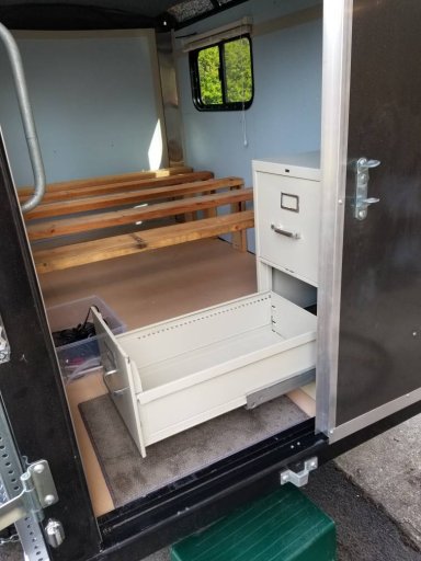

I also found a $2 file cabinet at the Re-Store, we needed more storage for clothes than the plastic box I had. Fits perfectly! Doesn't look great but I don't care, it's functional. 20181005_133836.jpegScreenshot_20181005-134447_McMaster.jpeg20181003_115218.jpeg20181003_115300.jpeg

Cool stuff! Definitely expensive, a 600lb capacity 60" full extention tray from slidemaster is $762, and I'd still need to build the box with dividers. Wish I could afford stuff like that.

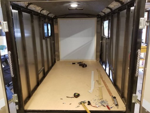

So I'm getting some backpay, aka trailer money, lol. So I ripped the inside out so that I could do bunch of stuff. A side door will be installed, walls insulated, new wood inside (the stuff it came with was trash plywood, I'll be installing something much nicer). The rear 18" will be walled off, and the back of the trailer will become a galley with a fold-down table. Started by gutting the trailer today!
