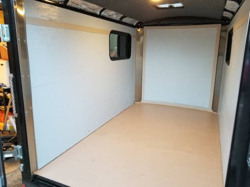

Paint is done inside, since we ran out of paint last time I decided to use a gallon that was left in my garage by the previous owners of my house (bought it in 2011, looked old then, lol). Turned out to be a nice blue, got the trim done in light grey, and painted the floor with some tan paint that was also left behind. 20180908_192843.jpeg20180908_173904.jpeg

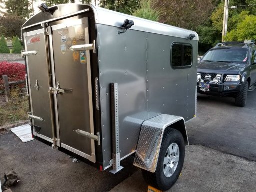

Hello! I think the trailer was about 3700 in the end (roof fan, led interior light, windows, 4" lift, custom fenders, tongue box, trailer brakes, and the trailer is also an upgraded model with thicker flooring, undercoat, etc.

So this weekend we drug the trailer around, went up and camped at Triangulation Point with other OB members. It was a success! We slept great, stayed nice and warm. The suspension is way too stiff right now, but before I go changing things we're going to build out more of the trailer as we'll be adding weight. The next project will be the side slide out kitchen, and bed frame.
