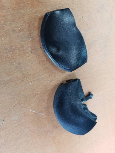

I also got the diesel heater going, and proceeded to melt the outlet vent I bought. New parts are on order. I'm also not happy with the plastic fuel hose and all the clamps, so I'll be researching a better solution for that, but it seems to be the standard unfortunately. I didn't route it permanently so it'll be easy to change.
