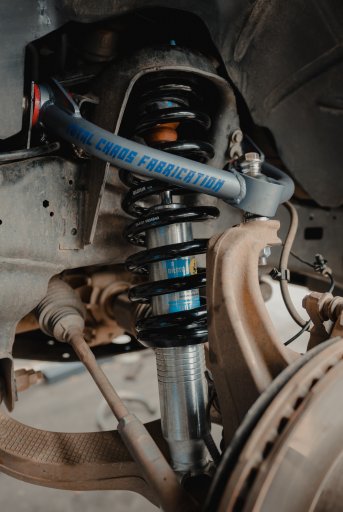

Switched from Falcons to Bilsteins 6112's. I Will be switching the rears to 5160s soon but for now, running the Falcon rear shocks as well. I also added in the Total Chaos Fabrication uni-ball upper control arms. So far way better than the previous setup. A lot like the stock setup, the Falcons rode pretty stiff.
I'm on the highest setting on the Bilstein. and haven't had any issues. A bit of rubbing with the 35s but might be able to solve it with an alignment adjustment.

Love you build progress. After lots of research and digging I ended up ordering same Bilstein setup too. Heard nothing but good about them. Can’t wait to install them.
