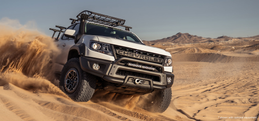

AEV has Both ZR2 Bison and plain ZR2 options!!!
I have not heard this anywhere surprisingly. I was just surfing around on AEV's website this morning and happened to notice it. AEV now has options of 35" tall tires and 4.10 re-geared trucks strait from dealers!!! What!!! And for those who prefer the ZR2 front bumper... you get to keep it.

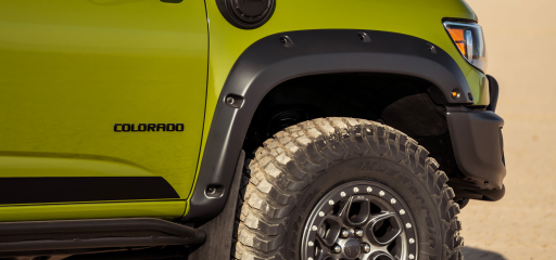

Just got and email from AEV stating that the Highmark fender flares are now available for ZR2 and Bison trucks.
Here is what the email said it enables you to do with the truck. Pretty impressive!
"These high clearance fender flares open up the front and rear wheel wells substantially, making room for a 35” tall tire with NO LIFT! This allows you to take full advantage of the ZR2’s extremely capable and incredibly well-engineered OEM suspension system, while also maintaining a lower center of gravity with all the floatation and ground clearance of a larger tire."
So... long story short... IF I were young and Single. I would now have a Colorado Z71 that I paid just $32.5k for... and be about to throw on a small 2" lift (but high quality)... and all of the AEV goodies like bumpers, skids, rims, and then throwing on some 35" tires/and a re-gear once the current ones wore out.
All for under $40k and spread out over time. Not bad.

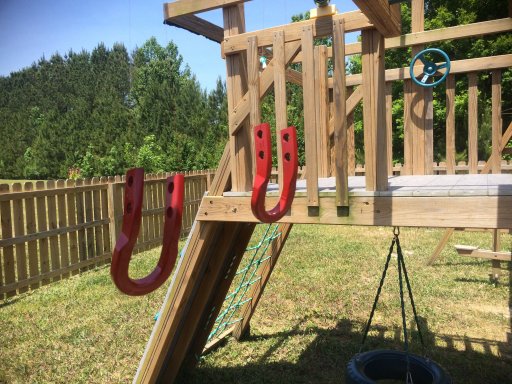

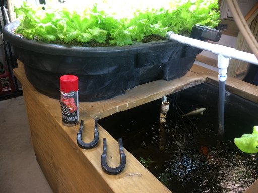

Upgraded the front tow hooks. I used red brake caliper paint (that I plan to add to the actual calipers at some point) after sanding roughing paint and then cleaning with alcohol. At least they are noticeable from further than 3ft away now.
Subtle but nice!

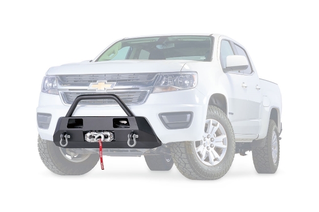

Another semi-hidden winch bumper has hit the market. WARN
KEY FEATURES:
• Fits all current WARN mid-frame winches (excluding M8274-50 and PowerPlant)
• Easy install–no need to relocate the winch control pack
• Built-in port for clutch lever access or lighting (except 3rd Gen Tacoma)
• Provides two recovery points for shackles
• Low-profile 2” grille guard tube adds front-end protection
• Constructed of heavy gauge steel with a durable black textured powder coated finish to protect against corrosion.
• Made in the USA

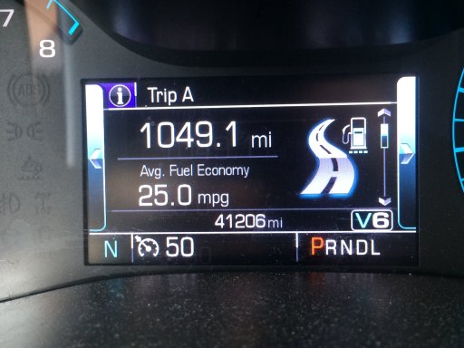

I recently took an emergency trip down to GA to assist my brother to take care of my grandmother (Cancer). Anyways, I reset Trip A at the beginning of the trip. Took a pic after I pulled into the driveway at the end of the trip.

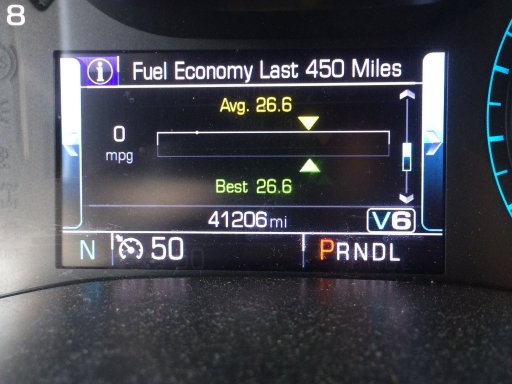

25mpg for 1k miles. Lots of 70mph driving. Lots of traffic at times too though. Air dam removed. The MPG was climbing on the return trip since the winds usually blow North during the Summer. Last 50mi or so were spent cruising slower and fuel economy was SUPER high.

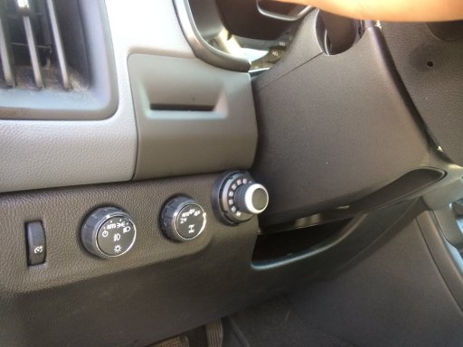

Yesterday I installed a Curt Spectrum brake controller onto my rig. The only modifications required were splicing a wire harness into the factory one (Which already had pre-made terminations made up so that was super easy)... and drilling 2 holes to mount the switch.
Here is the ONLY THING I can see from the trailer brake controller. Not too bad....
The part that took the longest was running the wires securely and neatly so as to prevent chaffing/problems, find a place to secure the main module remotely, and figuring out where to mount the control head/interface switch.
Final product is simple and sweet. She automatically adjusts herself. Even applying more or less trailer brake depending on situations like going up or down a hill... etc.
If the trailer starts to sway I can just quickly press on the control switch and it will apply just the trailer brakes.

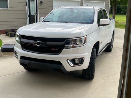

Got some new shoes for the lady yesterday. Some stock sized KO2s.
Man those things look beefy compared to my work out stick tires!

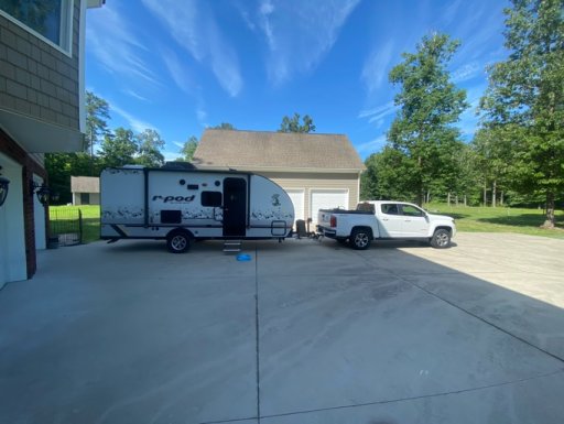

Some quick pics of the rig as it sits today.
She is hitched up and ready for the long haul out west. First main target is Glacier NP we will be dropping the trailer there for 5 days and exploring the area.
