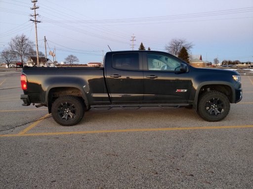

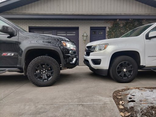

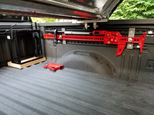

Great thread and info for the Colorado/Canyon! Many thanks to great08 and the others I recognize from the Colorado Fans forums like JCWages.
So far my Z71 CCLB has performed well in out on the Michigan ORV routes. The goal is to head out to the Rockies this summer for some mountain trails.
Since my truck is my DD, I've been setting it up as the "incognito" overlanding rig where all the gear fits under the Diamondback cover.
Truck mods so far:
- Removed Air Dam
- Added OEM Fender Flares
- RC wheel to wheel side steps w/ third bed step (don't do rock crawling...yet)
- Diamondback SE Tonneau cover
- 589 Fab Skid Plate Support Bracket
- 589 Fab Ultimate Rear Shock Skids
- Front Skid Plate, non-ZR2 OEM aluminum, Part #84352135
- AEV Engine, Transmission, Exhaust Crossover, and Transfer Case skid plates
- Peak Suspension Summit Kit w/ Add a Leaf, 550lbs/in, set to 2.7" lift, and diff drop
- Sway Bar drop kit
- Merchant Automotive SS Tie Rod Sleeves
- Unistrut bed rails for equipment mounting
- Sealight S3 LED Headlights (9005 HB, H11 LB) / Fog Lights (5202)
589 Fab is fairly local for me and did an in person pick up, good guys and quality products. The AEV transfer case skid plate will fit CCLB, you just have to use some rivet nuts to anchor it into the side frame (install pics and notes here: AEV Bison parts - thread for info and discussion)
Future plans:
- DV8 887 wheels
- 275/70/R17 tires, probably K02s
- Bed plate for anchoring, use 1/2" Baltic Birch with Tee Nuts for bolts (similar to Goose Gear's base plates)
- Pull Out kitchen / Bed Drawer (see PapaDave's project Tacoma Overland Drawer 2.0)
Cheers!
Awesome Build!!! And thank you for the compliment!
Yes there is indeed several folks from the Colorado Fans forum lurking around on here.
I especially am attracted to how you have your spare fuel tank setup!!! (Above pic)
I have been wanting to permanently mount one in the same location... but tucked in behind the fender well. That way... I would never have to remove it. Not when filling OR when using it to fill the main tank of the truck. I would just grab my auto-siphon hose and fill up the truck when needed (Or mower or ATV)
Placing the fuel tank in there would keep it out of the elements (mainly rain) as well as just not be in the way at all. All while making it painless to use too.
What fuel tank and tank bracket are you using?
I like those brackets along the bed sides! I am currently trying to figure out how to have a station setup for my Ryobi 18V +1 system. I may turn the underside of my back seat into a power toolbox/charging station.
Thanks! The truck is a work in progress like most of us here, getting things when I need them and budget allows.
I used the 20L Jerry Can Holder, usually about $45: or Jerry Can Holder 20L

About the crank handle, depends on how close to the hitch it is, my tire is about 8" out from the ball. Opening the swing arm depends on how long the tongue is. maybe this pic shows the room avaliable. You block about half the camera view, you can relocate the camera or use the mirrors, I got used to it quickly. You don't give up much departure angle, you extend the receiver hitch about 6" at oem height.

You can lock the swing arm at 90*, 180*, it can go more than 180* open depending if you the fuels cans mounted. The hold open pin is very robust, the close pin is 3/8 and not going to break. I've had this for two years now and it's rock solid, no rattle.
Thanks for going through the trouble of adding a angled pic and describing your setup a little better!
