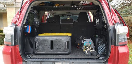

Got the Rago shelf installed! Its pretty nice... very solid. I wouldnt hang from it just because i dont want to damage the trucks built in mounts, but the rack itself is prob strong enough to take it. I mounted mine at the highest level up. It doesnt interfere with the rear view mirror at all. The top also holds a good bit of stuff. See pics below! Also, I ordered the Wilco offroad offset hitch mount tire carrier. Ill post pics and review it once i get it installed and use it a bit.

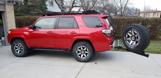

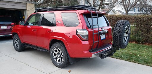

So guys... i bought the wilco hitchgate offset with the goal of carrying a second spare tire. (I want to drive the Dalton highway in AK, ive read having 2 spares is smart) I ran into a problem however... the spare under the 4runner prevents the hitchgate from sliding all the way into the hitch. Id rather not move the original spare from under the rig, as it would take up lots of interior space. My roof rack is already full as well. Has anyone else encountered this situation? What did you do to solve it? Im considering modifying the hitchgate, as i dont plan to tow from it.
View attachment 129053View attachment 129054View attachment 129055
I love that interior rack! Nice build, brother!

Heres what i did for now with the Hitchgate... and im going to test it a bit locally before i make the permanent decision. I kept the spare. Removed the extra wedgelock part (just unscrewed it, no cutting). Its removal bought me just enough clearance to get the Hitchgate to the first hole in my receiver. I went to the hardware store and bought a heavy duty fully threaded stainless bolt. I put the bolt through the receiver and into the Hitchgate. Inside the Hitchgate (this was the hard part) i put a washer and one of those nuts with nylon? that doesnt spin. Then i threaded it though to the other side with my ratchet, and added another washer, locking washer, and nylon nut. When I tightened up the exterior nut and head of the bolt, it pushed the interior bolt sideways. This sandwiched the Hitchgate up against the receiver nice and tight. Theres a small gap on the other side that im going to fill with some kind of wedge. I was able to stand and jump on the Hitchgate with almost zero movement. The whole truck was moving but almost no budge on the Hitchgate. Its not perfect, but its pretty darn good. My only concern is that any tiny movement will eventually turn into more over time... so i need to get the other side wedged just to make it a little better. 20191207_163428.jpg20191207_163419.jpg20191207_163317.jpg20191207_163259.jpg20191207_163451.jpg20191207_163507.jpg

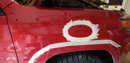

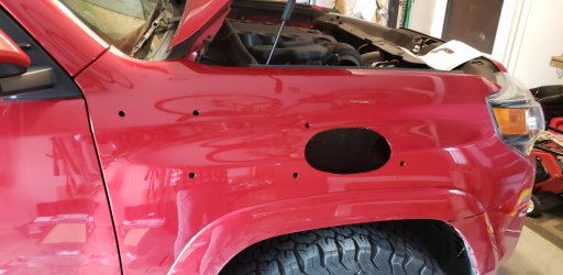

Hyperion hit a deer at 65. Smashed up the front passengers side, blew all 8 airbags. :disrelieved: No injuries except to the truck...
Sorry to hear the news but I'm glad to know there were no injuries... Although, I assume the deer was injured a bit.
It's crazy to think you can spend so much money on vehicle protection but such a small split second can make it all null and void.
What's next for you?! Can you salvage anything from the 4Runner for another application?
