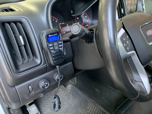

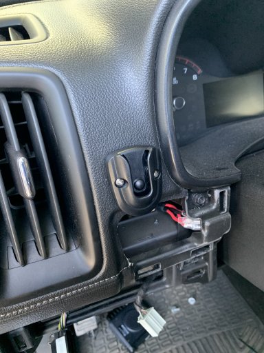

Today I installed a GMRS radio setup, I put in the Midland MXT275 MicroMobile. I like this unit a lot because all of the controls are on the mic and the unit itself can be stowed away. I put it under the kick panel and attached to the metal shield. It came out pretty clean and not noticeable but the front of the unit is fully accessible without having to remove anything. I also built my own harness for it with an inline bladed fuse because the original comes with a glass fuse but I carry extra bladed ones in my truck and wanted it the same.
I built a small bracket that attached to my CBI ditch light bracket for the antennae and routed it through the fender and the side of the dash behind the doors weather stripping.

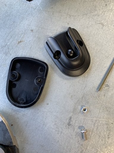

Then came time for the mic mount to be mounted, the GM twins really have almost no flat spots and the material the dash is made out of does not accept adhesive very well. Midland includes a decent mount but is adhesive only so I pulled it apart and drilled a hole into it and into the dash so I could hard mount it with a small nut and bolt. worked out really well and its very solid.
Here is the "almost" final product. I really like how it turned out and cant wait to test it out on the trails.
I say "almost" final because i don't want to plug the mic directly into the unit as it leaves the cable pretty close to my feet when driving. I already have Midland's mic extension but I'm going to purchase an RJ45 coupler and install it into the dash in a more convenient location that moves the cable out of the way.
