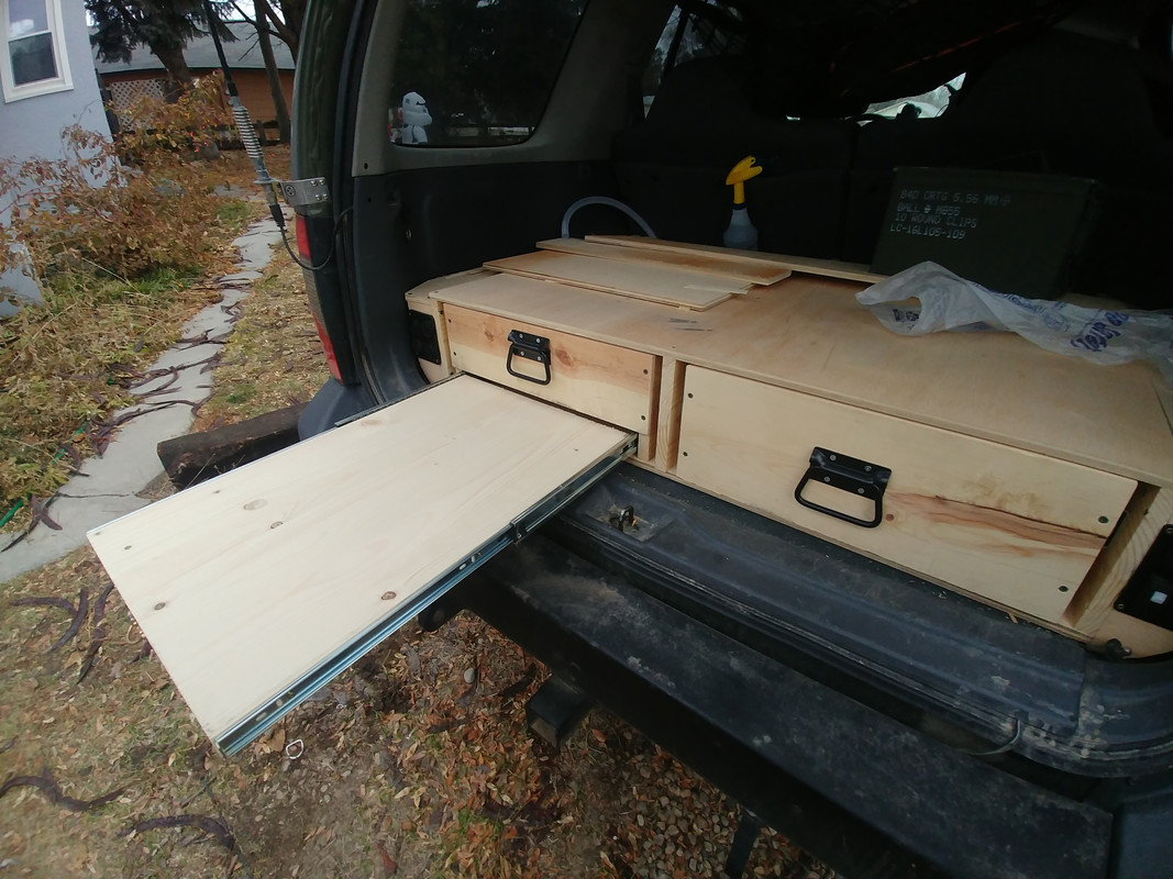

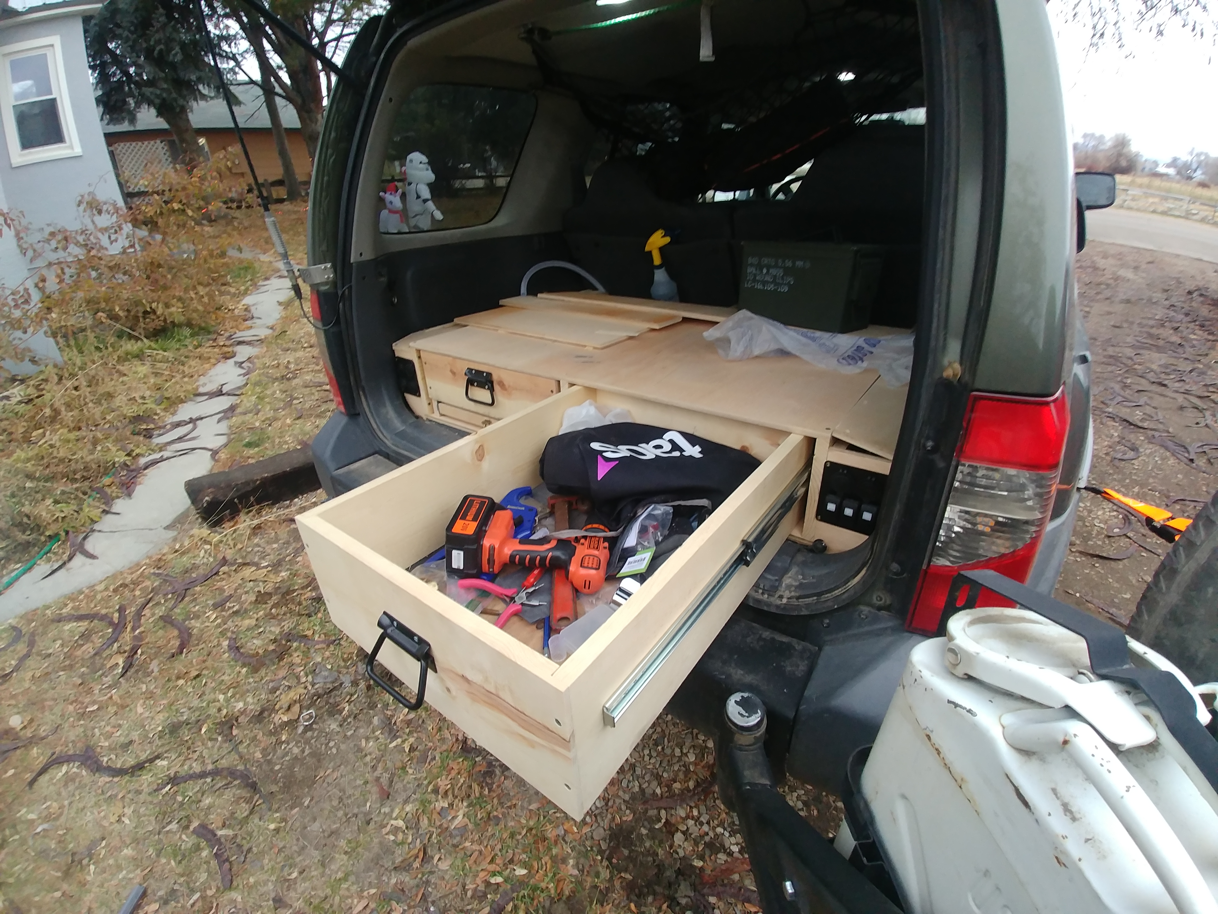

I finished building my drawer system. I haven't painted it yet (been too cold), but I'm very happy with how it turned out.
There's some things you can't see in these pictures. There's a faucet behind the passenger tail light. All my electrical is underneath a hinged door, and behind the drawers, up against the seats. I have 5 more relays for lights, and one more switch open on the panel on the right side of the drawers that I'm not sure what to do with. I'll also probably replace the USB ports on the panels with USB 3 ports.
Do you have any idea the weight of it? Is that 3/4 pine for the sides and drawer fronts? are those locking slides?

Weight honestly isn't bad. I can pick the whole thing up without too much effort if it's unloaded. Drawer sides and vertical supports for the platform are from a 1x8, so yeah, it should be about 3/4in. Top of the platform is 1/2in plywood. With the middle support, 1/2in barely flexes even with me on it, so it should be totally fine. Slides are not locking (I didn't want to pay that much). The slides I bought were $40 each, and hold 250lbs. A couple of barrel latches keep the from opening.
