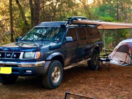

I got the eBay one. Does not fit the V6 ...Some PVC pipe and end caps made it work well (see pic). I think for my wife’s xterra she will probably end up buying a name brand one if such a thing exists but the eBay one works with some creativity
