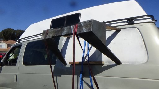

Just came in, modified the roof rack today to hold it and popped off the old ARB small awning. This one puts a whole lot of coverage around the side and back of the van (not many awnings are big enough) and actually cools down the interior by a noticeable amount

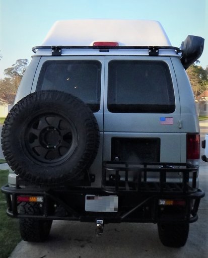

what is the roof rack you have for the awning?
Custom built. I used work van ladder rack for the clamps that attach to the rain gutter and welded those to a giant U shape I bent out of 1"x1" square tubing. There are 8 clamps, 2 at the rear and 3 on either side
It fits around the sides and back of the high top with a slight bend downward just aft of the front doors to contour the rain gutter. It's secure enough for the awning or as a decent hand-hold. Eventually I'd like to replace it with an full aluminum roof rack, but we'll get there when we get there

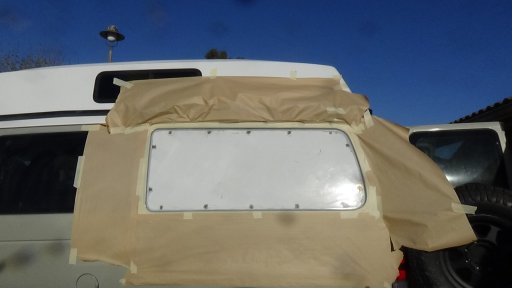

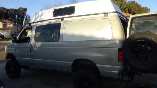

The window is gone! And I'm updating/fixing the aux tank fuel fill neck.
Wife n I planned on deleting the rear driver side window from the beginning (originally both, but we decided to keep the pass rear window). There was a company out there that used to make aluminum window delete kits but they appear to have disappeared, so what's an amateur welder to do?
Window "blank" cut from a junkyard work van (has the required curvature) and conveniently the bolt holes for the original window are the same diameter hole I would typically drill if I'm trying to emulate a pinch weld using mig.
Weld through primer paint and "weld through" seam sealant were used in between the two sheets of metal and securely(?) clamped using a saw horse. Prime note for anyone wanting to emulate, I've discovered the "weld through" seam sealer is for resistance pinch welding ONLY...
I may have earned my callsign "Smokey" all over again today...
Prepped for paint and final result. It looks nice enough if you don't get up close, but it gets the job done, increases our privacy, and gives us much more surface area for insulation later on.

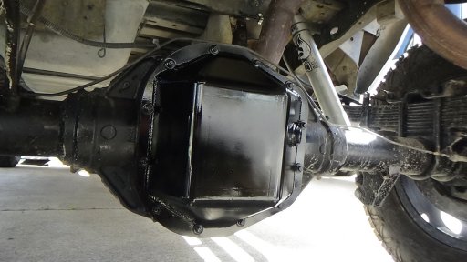

Ok, so kitchen is now quasi-finished and the diffs have new oil with armored covers. Installed a bowl (which will eventually have a drain), electric water pump, and water sprayer onto the kitchen box. The elec pump has generic water quick disconnects to hook up our water jerry cans

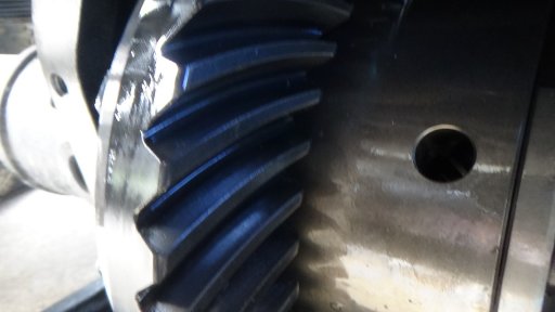

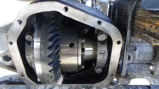

The differentials have 500~800ish miles on em now (DDing in 4x4) so I figured it was time to exchange the fluid and add armored diff covers. Rear turned out alright but I'm worried about the front.
Rear fluid came out clean and clear as I was hoping, I did see a little bit of wear on the toe of the gear but its nothing I'm worried about. The front fluid came out opaque and slightly sparkly, I also found a bit of dirt in there but that could've been from the removal of the original cover. There didn't seem to be any wear on the gears but the opaque fluid probably means I need a rebuild. I'm going to wait and see for now, considering I won't be running it in 4wd all the time I don't think it needs to happen right away.

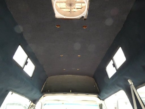

Another very late van update, but the interior is starting to take shape!
Got everything sanded, the walls and ceiling carpeted, along with wood paneling a the floors and a few walls:

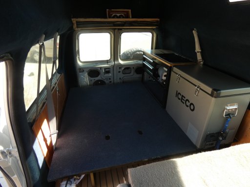

After cutting down our conversion-van bench by about 5" we were able to get it bolted down with our 60L fridge sitting right next to it. For now we'll rock it as is but I do plan on welding up a little kitchenette to go where we used to have the fridge. It'll bolt right into the same spot the old set-up did and include a burner/sink combo, water storage, and all the drawers we need for our camp-kitchen gear.

So, we completely changed tact for the kitchen, bench and bed layout. When we went camping with it we didn't like how we had to remove car seats and fold out the bed in order to get ready, lot of bulky moving about. So we opted for a bit of a hybrid of our original sleeping layout and the new; permanent bed platform, kitchenette is now behind the refrigerator, and I made new seat brackets to move a permanent bench rearward from the center section:
Electric pump and propane are hooked up through the underside of the bed platform, two locking drawers, and just some cubby space. Propane is fed from outside the van on quick disconnects.
We have a back-up mechanical water pump up front using a little sprayer hose from our last kitchen build, 20 gallons underneath the bed, the 2 or 3 person bench (and car seats) no longer has to move, and the upper cubby w/ electronics is finally filled in.
Overall I think this layout will suite us better, much easier to park and immediately have camp made. We don't intend on cooking much inside the van, for the most part we will use our outdoor stove, but it will provide the convenience of making coffee inside on a cold morning. Figured it was worth the trade off

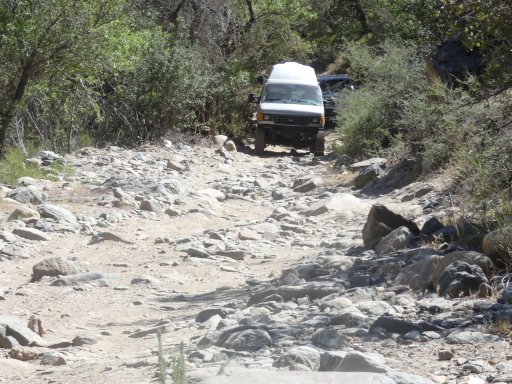

Trial by fire! Took the big girl up the Backway to Crown King and the Senator Hwy to get to Overland Expo West. The new camping set-up worked great, we were able to set up and break down camp much quicker to get back on the road!
Some trail damage, actually bent the crossmember up enough to touch my exhaust, our mid-destination at Crown King and camp at the Expo
