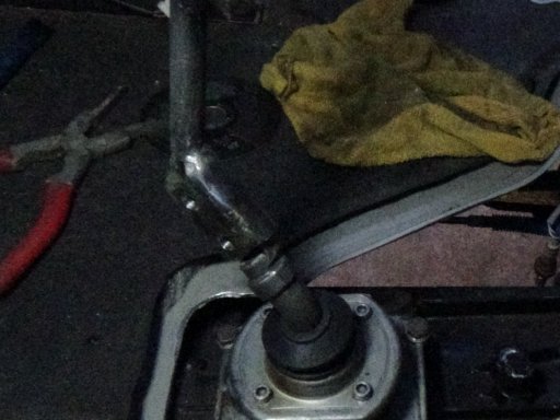

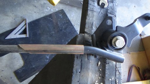

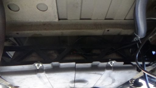

Front suspension removed!
View attachment 179695 View attachment 179696

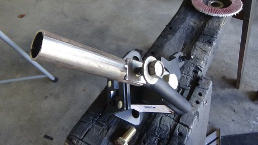

Also removed the transmission and front section of the exhaust at the same time. I highly recommend that if you're doing one of these UJOINT kits, makes it way easier to get in there and weld on the shackle hangers. I suppose for the other kits out there that bolt on new radius arms for '05 and newer Super Duty axles you could leave the trans but the exhaust would still need to be modified.

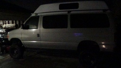

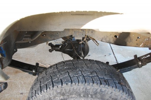

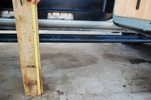

Here it is with the axle in place!
View attachment 179697 View attachment 179698
Much taller in the front now! Rear axle being prepped for this upcoming weekend, should be a much simpler affair. The instructions were great and easy to follow but I'd recommend piecing together your own drill bit kit; the DeVault brand bits at HomeDespot didn't break on me, cut through the frame better, and were cheaper.
Sorry for the sparse pictures, finished this up at midnight so most of my pics are cr*p and tbh there are plenty of pictures and vids out there on these kits. I'll get more detailed for the manual transmission swap though, that'll take much more fabrication/detailed instruction if anyone wanted to duplicate.
