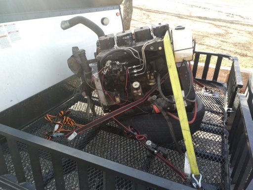

Time to resurrect this build thread. Been settled a while and the new garage is mostly in order, plus we have a new(ish) engine. Decided to take a bit of a middle road between options 1 and 2, and went with a Cummins 4bt. Still smaller displacement but much lower end torque than the 606 with way easier to find parts. It will also be easier to stuff into the van's engine bay and hopefully still get decent fuel mileage.
Bought this industrial 4bt from a gent two states away, he was offering quite a bit more for the cash but my jeep was overloaded with just his engine and transmission. Still very thankful for the deal he offered and that we made it home without issues.
The weight of the engine and trailer were well within the Jeep's tow rating but with how our little toy hauler situates it's payload I way overdid the tongue weight capacity. Poor thing now has a permanent sag in the back but I'm not too concerned since I've had a new complete suspension lift sitting in the garage waiting for me to install.
The package as a whole is the 4bt all dressed up with automotive 12 valve parts already on the front end, and a 460 or IDI (not sure yet) pattern ZF-5 transmission. It's way easier to find older style Ford bell conversions than it is for the Ford MOD trans I currently have in the van, so that was a major plus.
The injection pump is supposedly bad but I haven't tried to start the engine since getting it home. Considering my last foray into used diesels, and the guy's upfront honesty on the IP being bad, I think I'll just plan a full teardown and refurbish for this engine with a new automotive style VE pump. The 4bt should be a much more simple engine to cut my teeth on rebuilding than the Mercedes and a fraction of the price to build for the performance I want. More info to come as we get this on a stand and start the teardown.
